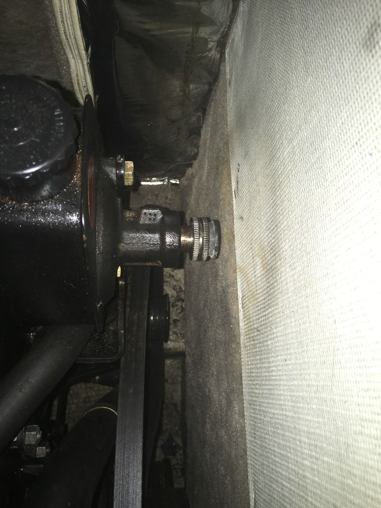

This past weekend, I fell victim to the dreaded plastic pulley breakage on our 97 5.7. We were cruising at around 2900 rpms, when my wife said she "heard something" and the steering all of a sudden got tougher to turn. I cut power and shut her down within 10-15 seconds of this all occuring. I opened up the hatch and all that was left of the pulley was what you see in the photo.
I don't believe any other damage occurred, the temp gauge never much higher than normal, certainly not into overheat range. I didn't smell any burning rubber smell. To me it looks like Merc issued a recall on these pulleys but that has long since expired. So I understand that the 4.75" plastic is to be replaced with a 5.75" metal pulley and new serpentine belt. The current pump seems to spin freely and the belt looks fine overall, so I don't suspect any other accessories had seized that caused this.....A little disappointing that our day was cut short over a stupid plastic pulley :(
I can pull apart my boat to get access to the front of the pump, however, I am wondering if it would just be easier to remove the pump and do all the work out of the boat? I do understand that I need a pulley puller. What about putting it back on? A vice or press?
Or another thought, since the pump is well near 20 years old, should I find an OEM retrofit and replace the entire pump and pulley?
My only concern with unhooking the pump is bleeding/introducing air into the lines. I know how to bleed brakes but not a power steering system.
I would appreciate any input or any advice anyone has on this!

just refill and run it, it will self bleed, a few cycles of full left and right.I would just replace the pully without removing it.
50,295
just replace the pulley, top of the fluid, spin the wheel lock to lock a few times to bleed and go boating.

I had the exact same thing happen to me. I found a replacement pulley and belt at a marina. I went to a local Advance Auto and got a GM power steering pulley removal and installation tool. I replaced the pulley and we were back on the water. I think the whole episode only took about 2 or 3 hours. I don't see why you would need to remove the pump unless your engine access is that tight. I found it helpful to have the pump still on the engine. It held it still and when I put the belt on it held the pulley still while I tightened it back on the shaft.

If it's as tight a fit as the photo shows, it might be best to take the pump off.

I would either remove the pump OR drill a huge hole in from the front so you could install a new pulley. but that hole is going to be huge. :facepalm:

Thanks for all the help and advice guys! As it sits, yes it would be a tight fit, much too tight to be able to do the work needed. What you are looking at is the back of our bench seat. It really isn't a huge issue to remove it to work on the pump. However it's held together with brackets and a bunch of stainless screws - a lot of them!
So I can either remove the bench seat or remove the pump. I am kind of thinking keeping the pump in place is a better idea. I am not a huge fan of pulling off hoses if I don't have to....It should also help with keeping the correct tension on the belt when it gets re-installed.
