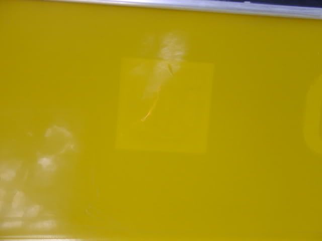

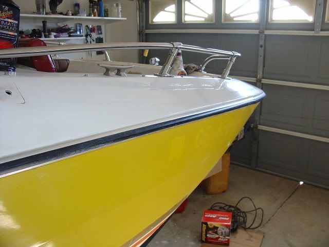

I have started to wetsand and buff my gelcoat. The color has come back from what it used to be, but where the old decals where the gelcoat is a brighter yellow. No matter how much I buff I cannot get to the original shade (under the decals). I don't want to rub all the way through the gelcoat. As you can see, the white came back good.
Any advice?

Ayuh,... Odds are, That's the original color that was protected by the stickers, so it didn't oxidize...
Puttin' the New stickers/ letters in the same spots is the Easy fix...

Yup..thats the OEM yellow color under those decals..
You can try to wetsand and buff / blend but you might make the spot even more noticeable overall ( without sanding the whole boat ).
1. apply the new AZ numbers/tags and dont worry about it.. or
2. try 400/600/1200 spot sand/blend/buff and apply new AZs' ( Im sure its not only a different color but kinda lethographiced (raise) spots ) .. or
3. sand and buff the whole boat down to origional yellow.
There is no other way ( acetone wash wont do anything aside from getting you hi ) .
YD.

You might be surprised at how much less noticeable those shadows are after the new number are on. Both of my boats have shadows from old CA numbers. I buffed the boat and put the new custom vinyl TX numbers on in the same location. The shadows are hardy noticeable at all. If you don't point it out no one will notice.

I used 600 grit and could NEVER get the lines out...(I did have a little luck in making them less noticable)...Save yourself a huge hassle and headache.....it isn't gonna come back. I just wish I would have listened to the professional who told me that it would never come out....I am hard headed I guess...

couple of things that no one has told you that i have seen......but the stickers are your best option.
the day gellcoat leaves the factory it starts to fade....you have faded gellcoat....you cannot sand, to bring out the, color......it is now....what it is...
the only way to properly fix it is to re gellcoat the colored part of the hull......(not just the area)
but if you want to drop the 5k it will cost.....go for it.....other words....buy a sticker.

I have a 35 year old yellow Thunderbird boat. After all the buffing and sanding and buffing and polishing that I could stand it STILL shows issues like yours under stickers and stripes. I agree with oops: Your (and mine) gelcoat has faded and that's that.
I aggressively sanded one little section on the transom that had a vinyl stripe on there for 35 years...and could never get it to look exactly like the surrounding area.
I don't doubt that a professional could have done better than me; but after all the work that I put into it...I would not be surprised if his outcome would be essentially the same.
It would be nice if it was perfect...but I also agree with YachtDR,,,don't paint over gelcoat that looks as good as yours.....

Sanding on the areas under the sticker is not going to help, that is the original color, the rest of the hull is what needs to be sanded down to remove the faded surface, will it work...maybe...will you sand through the gel coat...maybe....will you find porosity...maybe....can these be fixed easily...no. Some colors can be difficult to bring back by sanding, can they be improved ..yes.
The custom sticker route is quick and simple and you will be the only person tortured with the thought that it is hiding the ghost of an old letter or number.
The sticker doesn?t need to be some boring generic set of numbers, it can a complete theme about as large and intricate as you like if you want it to be original.
