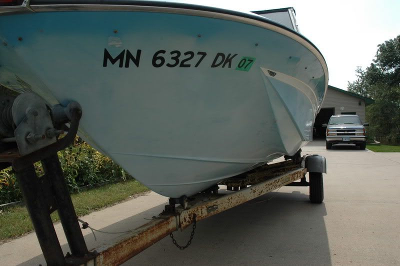

Hi all. I have a dilema. I have a 17 foot Chrysler Charger fiberglass ski boat. the trailer I acquired with it has some issues. First off, a tree landed on the boat, damaged the boat some, but also bent the axle. So I need a new axle. Plus I need to replace both bunks. Here's my question. I am trying to decide if its worth fixing this trailer or acquiring a different trailer in good condition. Would I be safe with a roller style trailer with this boat being its fiberglass, or do I need to stay with a bunk style. Here's are a couple links to pictures of the boat so you can see the existing trailer and the hull design. PLease, any and all advice appreciated! I need to address this issue before the snow flies. I don't trust the bunks to added weight from snow.

Seems you have a pretty long and flat keel under that boat. So it will rest easy without distortion lenghtwise. As the walls are pretty much upright the only function sidesupports would have is to prevent left-right wobble, and much less vertical support. I'd choose bunks for that if it's a single shell hull. For ease of launching and retrieval.... about even I'd guess with maybe rollers slighly ahead for retrieval. Guess this didn't help you much, did it d:) ? Happy boating, Blackhawk!

Although I'm a fan of "roller" trailers for deep "V" hulls, this hull looks like it would benefit most from staying with bunks.

imho, i'd slide that boat off the trailer, and make the trailer a winter project. axles are fairly cheap, be sure you get the right distance between the spring indents. i would sand grind every bit of that trailer, and then a couple of good coats of Rustoleum. new bunks, and remount the boat. here's another excellant source. champion trailers. com

Thanks for all your thoughts and opinion guys. What I'm looking at on the current trailer is the fact that its already been reinforced around the axle and had the axle replaced at one time already. Now it needs another axle, plus two fenders, both bunks and brackets replaced. a new winch, a handful of new rollers. So quite a bit. My other option to fixing this trailer up is to find a used trailer in good condition that will work. I've seen 16-18 foot trailers from $300 and up used. What are your opinions? If you were in my situation, what would you do? Fix the trailer or get a different trailer?
