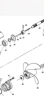

The parts diagram shows a part ( clutch spring retainer item #27 ) not sure where is goes.----You might look for it in your motor in your parts cleaner or on your shop floor.

Am I missing this part? Part number 46 that looks like goes in before pushrod/cam follower?

I’ve looked everywhere. I can’t find it or find a parts list for it to purchase one.
39,226
I see that item marked as #26 or #27 on my diagram.------It may in fact be trapped in the assembly on the end of the spring and it can not fall out.----Be easy for me to check this out.

Yes sir. I understand. I’ve replaced water pump on several, but first prop seal where I had to pull shaft out to change. Originally when I took it apart the push rod fell into housing. I took it out and cleaned. I was draining remainder of the oil, and maybe the small retainer came out. I don’t know. I took the whole thing with prop shaft out to my local mercury dealer to get seal. They had it out in store, and if there’s a retainer that’s loose, could had fallen out as several of the guys were looking for number on existing seal. My ignorance on this, I’m sure caused it. It has to be simple fix, I just don’t know what parts are suppose to be there. I took it to 3 local marine shops today and no one can tell me. Hard to find anyone that will work on them. I was hoping someone on here, would say yes there is a small spacer between push rod and split pin in shaft. I appreciate all your help, sir! I considered putting a small nut in the shaft for spacer just to see if it would work right. But of course I wouldn’t run it like that.
