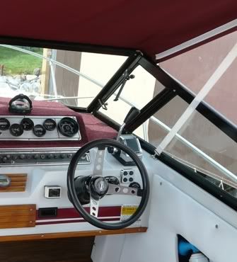

I have a 1985 Mark Twain Costa Brava with a 260 and Alpha 1. The button on the side of the shifter will not push in to switch to throttle only for start up.
I should say I let my daughter and boyfriend take the boat out and it worked before they took it but not after. The button is sitting at an angle. I think they bent the shaft the button rides on and pushes in.
Has anyone repaired one of these before. I attached a photo of the shifter to identify it.
