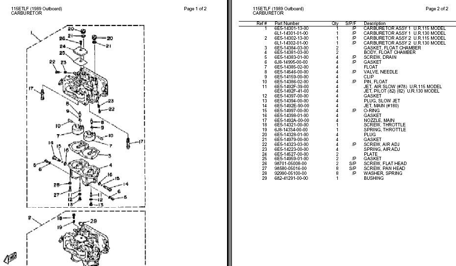

Here's a carb pic

Most Johnson/Evinrude carb kits will have a new float, needle and spring. New gaskets and o-rings where needed. They'll also have new plugs to replace the old ones that can be drilled out to clean off idle passages. You may need to go to a marina or marine repair shop to buy parts.

Call me cheap, but I recently pulled the carbs an my 1988 90hp for cleaning and reassembled them w/o new kits. The bowl gaskets fit into a recess and everything sealed back up nicely.

Thanks for the help! I think I found a source for carb kits. Will compare to quote for individual parts. Again, thanks!

The main parts you should need for that carb is the needle valve and bowl gasket.
