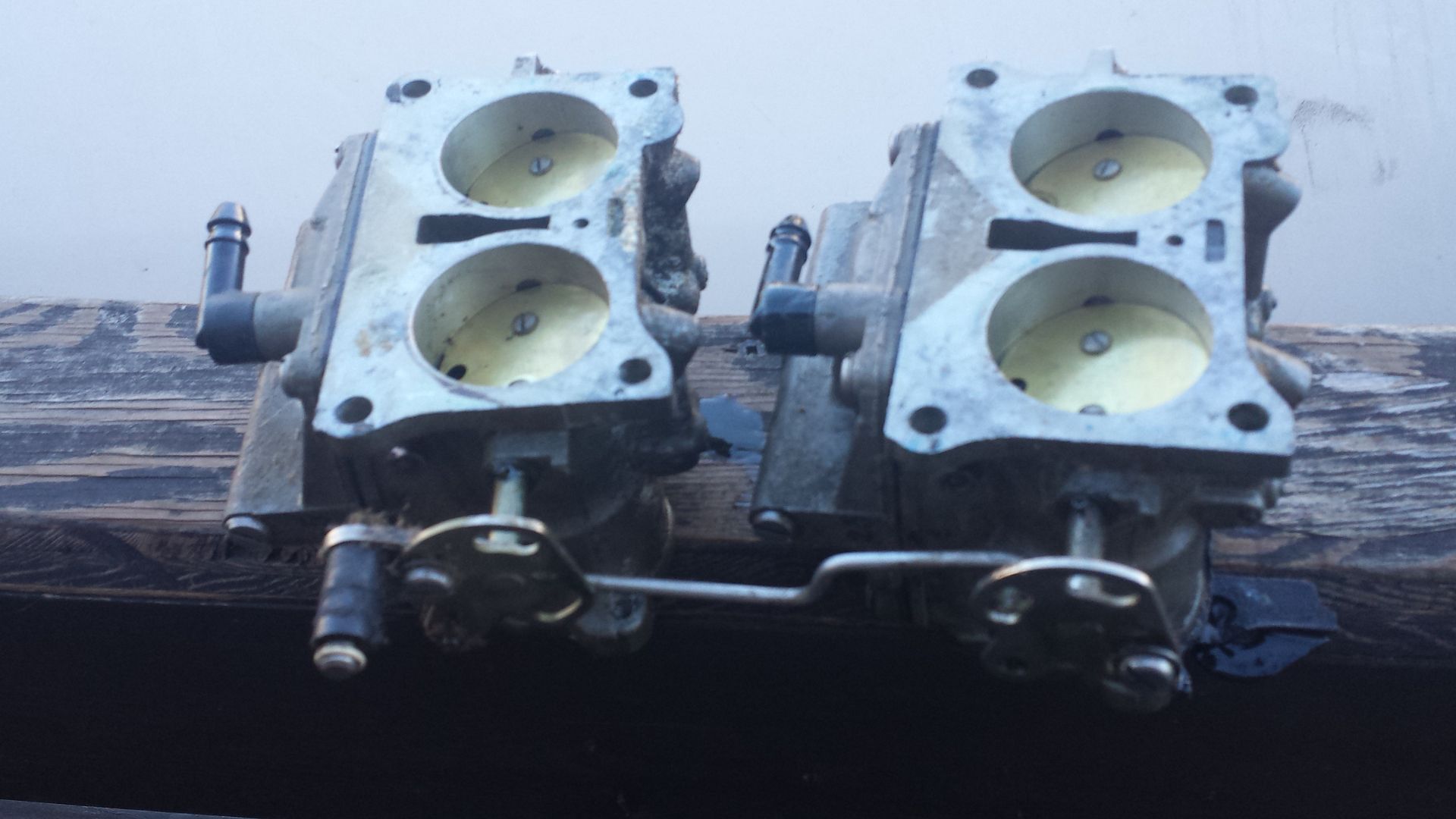

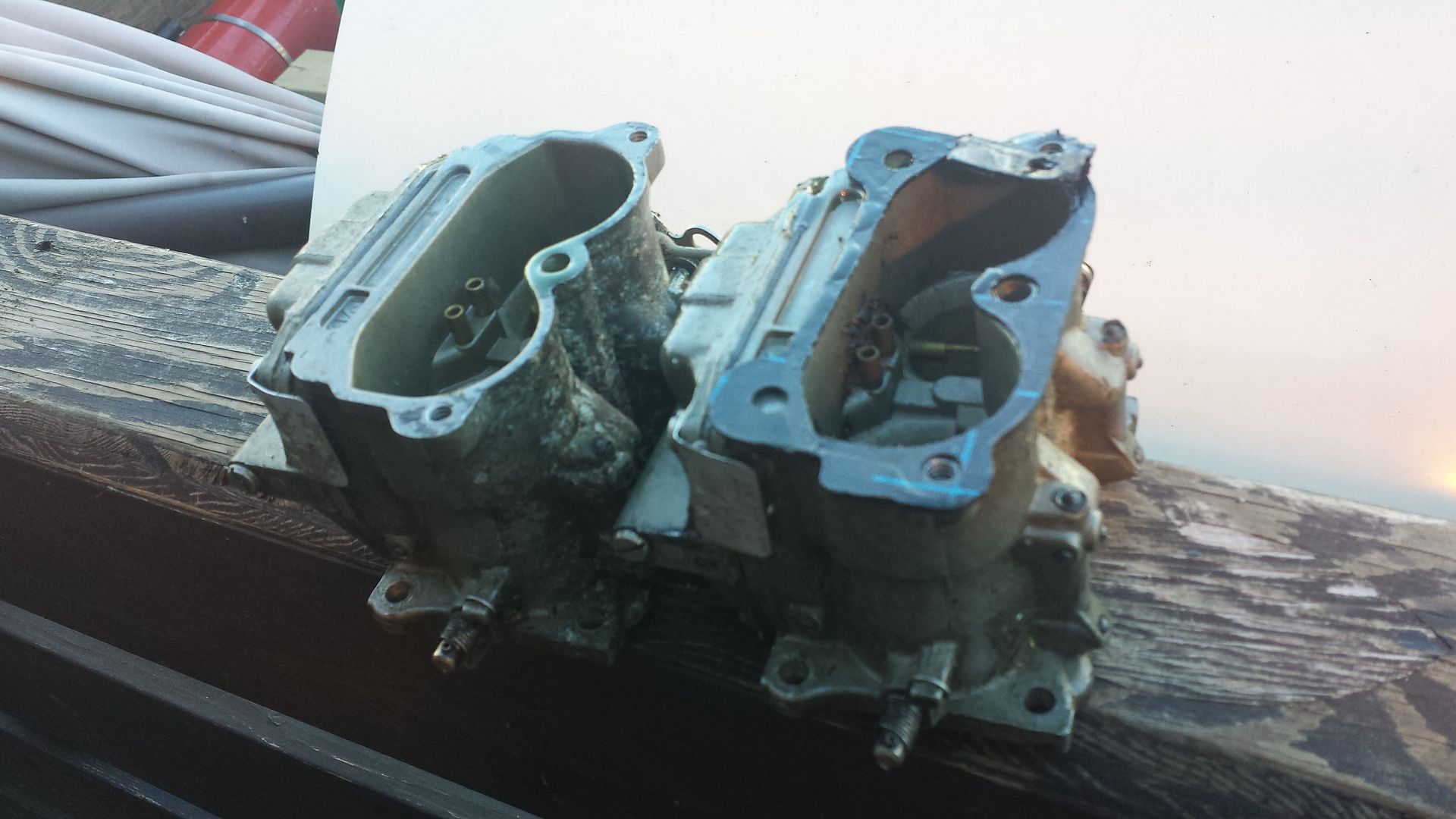

All I have to go on at this point is what he said for vintage. He is selling a combination of 115 and 140 parts, and when asked specifically about them being 1-3/8" he said they were. These are the pictures provided, but it kinda looks like they're 1-5/16" carbs which won't work... Still, I'm going to look as it appears he has a 17" SST on the parts list too.

These could be out of a 1980 V4. I don't see the idle air bleed jet between the two barrels. Which would make this a 2-jet carb, like your current ones.

From these poor pictures, they look like the carbs off my '82 90hp also. The bleeds on those are at the top front, just before the venturi starts, so you wouldn't be able to see them from this angle. Useless to me unless 1-3/8" though.

Have him send picture of front of carburetors. The throat size is molded in there on the lower right. Can't read it with how the picture is angled.

Indeed. I have asked more than once for confirmation of the size, and for updated pictures. Frankly, I think he's a flake and I'm whistling up my own a$$. Time will tell.
