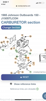

The black piece that receives gas broke.
I am not sure what to purchase. Am I going to need to replace the whole float assembly for the piece or would it even be included. It’s not shown in the prints I’ve found.
Please help.

Ok-----So what part are you talking about / looking for ?----Your post is not very clear to me.

no need to change much ....try to locate an eqv. brass nipple if threaded
if not threaded in the carb body thread the body for a matching nipple .
or.... try to find just the plastic nipple

First issue is the broken piece won’t turn or pull off. Is it safe to remove it by breaking the piece further

Find a used carburetor at your local boat shop.-----Find one on E-BAY.-----Drill and tap for pipe thread and a new nipple.----Choices are endless.-----Your location ?
