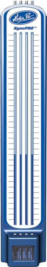

So 1 1/4 turn is the starting point? Also I thought you wanted low rpm at idle so you don't have clunking when shifting into gear,
This is the best way to get it right with this tool?

Hey mate, they don't like you cherry picking someone else's thread. Keep the questions to your thread. No worries.

Most engines have an in gear idle speed of about 600-650rpm, which in neutral could be any where from 675-1000, depending on what load was on the engine while in gear. A change in Propellers can result in a change in the In Gear Idle rpm.
Most Idle Mix screws/needles are set at 1 1/2 from lightly seated, and the Final Setting is 'Usually' Leaner than that, but not always.
As for what the Image was, I have no idea, what it was.

Oldboatfixerupper has his own thread....."1974 115"
He just highjacked this one because he didn't know better.
I think that tool is a carb synchronizer...probably for motorcycles.

that tool does look like a vacuum synch tool only used on 4 strokes. i have one at the shop for the odd 4 stroke that comes in, but 95% of the time its not needed as the factory sets it and they dont really ever get out of adjustment.
