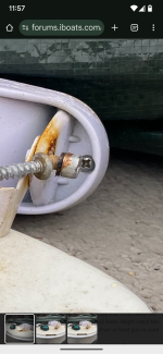

Looks like screws up from the bottom to remove the lense
Yes, that was my intention to begin with, but I couldn’t get the couldn’t get it off so I don’t know what that’s why I was asking for help. Well thank you qqqqqqqqqqqqqqqqqqqqqvery much for your help. I appreciate it.
