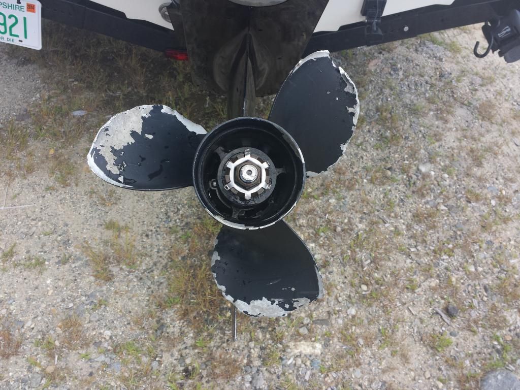

Saturday I went out on the lake with a bunch of friends. The boat was loaded heavier than it ever has with 6 adults and my 5-year-old son, she was sluggish for sure. While pulling someone on a tube I ended up over a shoal that I didn't know existed. I backed off the throttle, and like a complete idiot goosed the throttle trying to get back on plane to get the outdrive further out of the water. Stoopid move to say the least, the stern dug right in and the drive slammed into the rocks pretty hard a few times. We stopped, inspected the damage, and seeing a mangled prop headed back to the ramp. Hauled it out, replaced the prop, and not seeing any other obvious damage we went back into the water and continued on with our day.

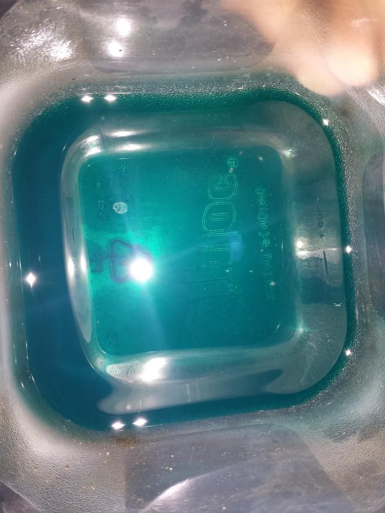

Today I drained some oil from the drive and it had what looks like water droplets in the oil.
I'm not absolutely certain the small amount of water wasn't on the bottom of the outdrive when I drained the oil or not. What do you guys think? Should I pull the drive and take it in? Would I hurt anything running it again next weekend to see if I lose more oil? There are no leaks with the boat parked.

First thing I did when I hauled the boat out was to check the prop shaft to make sure I didn't bend it. Spinning it by hand it looks straight as an arrow. The boat is a 2011 and turned 3 years old just a couple of weeks ago. I have a hard time believing that a seal would go bad after three years, or that this would happen within an hour of the hardest underwater hit this boat has ever seen. Just my thoughts though, I've been wrong before and I'm sure I'll be wrong again.
