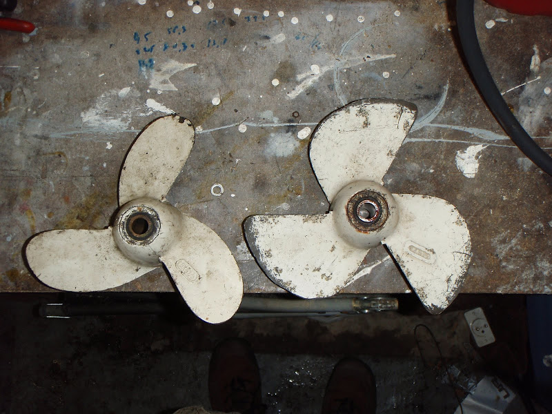

I'm rebuilding a 4 hp johnson 2 stroke outboard (1969) and have 2 props that fit it.
Which one would be best for my sailboat ? (it doesn't plane and has a hull speed of around 5 knots)
Its 5,5m long, 5m waterline and weighs around 700kg.
(18feet, 16.5feet and around 1550lbs)
The specs of the props that I have available :
8inch and 5.5 pitch OR 8 inch and 4.5 pitch
The latter does look a lot bigger though (see below picture)
steelespike
Apr 26, 2002
19,069
Re: choice of props
I think I would go with the 4.5 I think the larger blades will give better control especially if it has reverse.
Silvertip
Sep 22, 2003
28,771
Re: choice of props
You will definitely get more "push" with the larger blade area and less pitch. Agree also on the better control especially in reverse and to aid slowing when navigating in close quarters.
