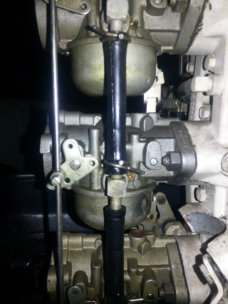

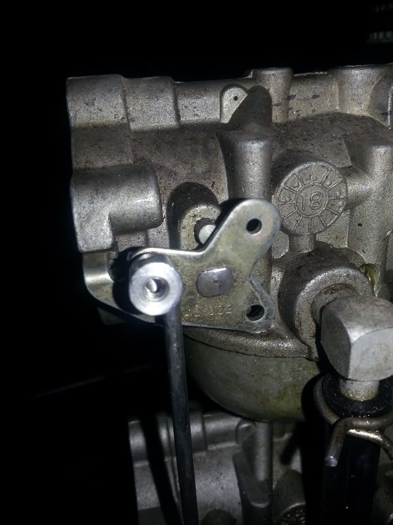

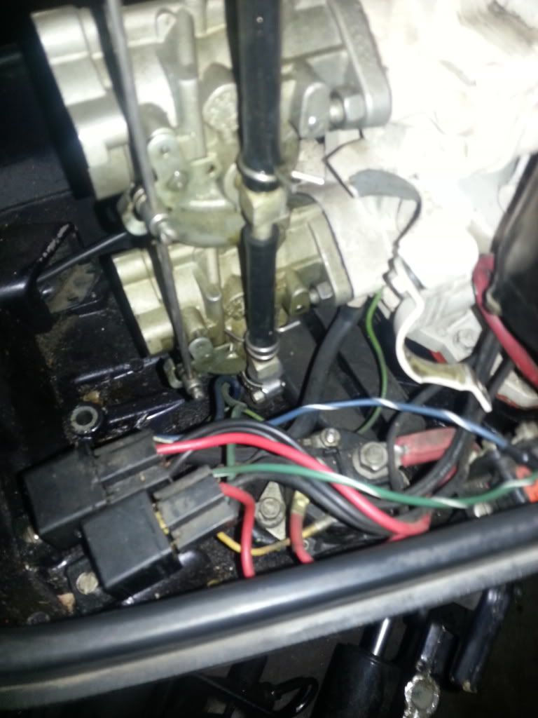

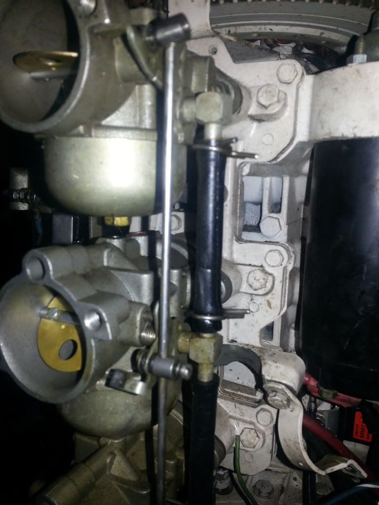

Hey guys, this may be a dumb question, but im still vwery new to boating. Would anyone have any instructions on how to install a choke solenoid on a 85hp '89ish force? I would really appreciate the input. Thanks a ton!! You guys are awesome!!

Do you have one?
You already have the bracket.
The green wire is the choke wire.
You'll need another screw.
Then the choke and plunger and the plunger rod.
The adjustment will come after the install.
Hook it all up and see the pics on e-bay that will give you an idea where to set the actuator.
