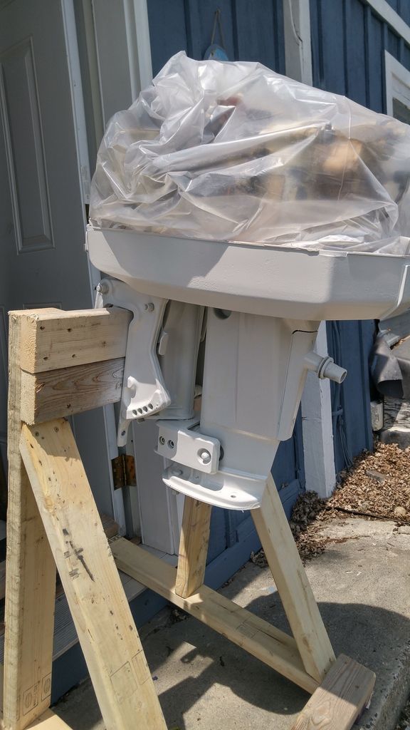

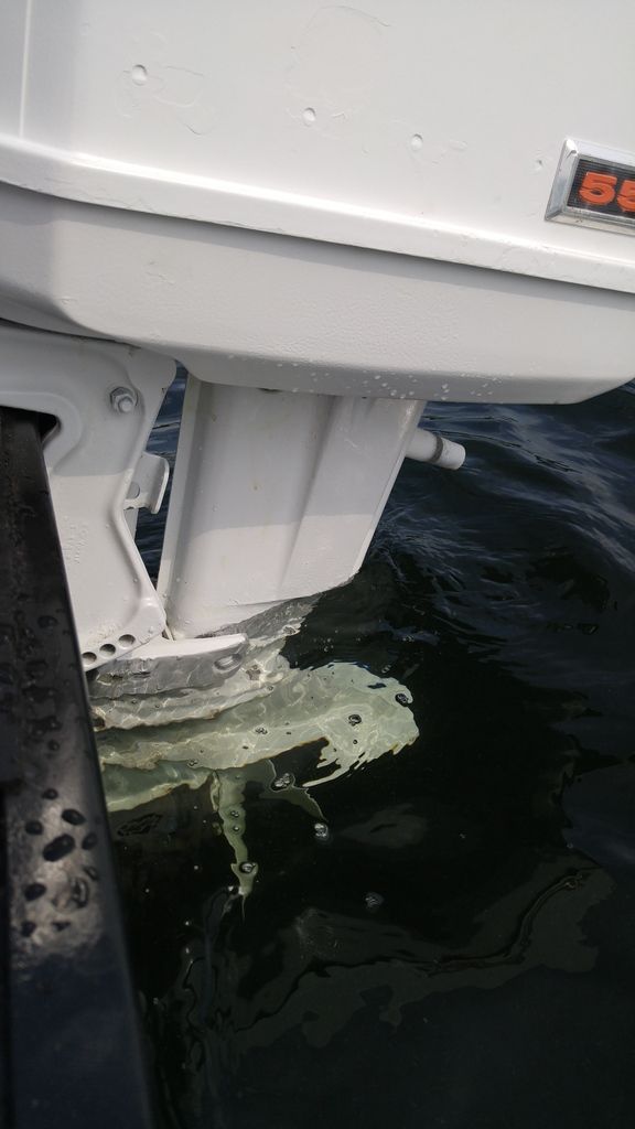

I had it in my recycle bin actually! lol. I had water way up the shaft farther than it would sitting in the lake. i plan on installing a telltale, here's a few pics. i do have a single carb.

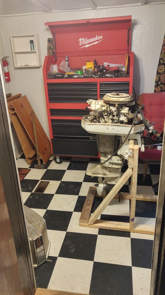

So i have water thru the system with the hose hooked to the impeller tube. No lower unit. Its kicking like its a bull. Im hoping to have it pumping its own water tomorrow so i can run it and try to figure out the kicking.

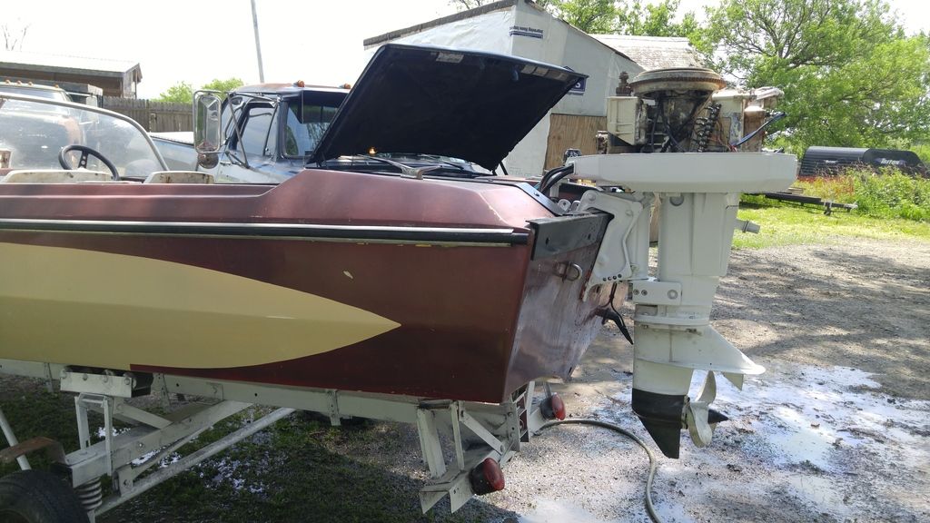

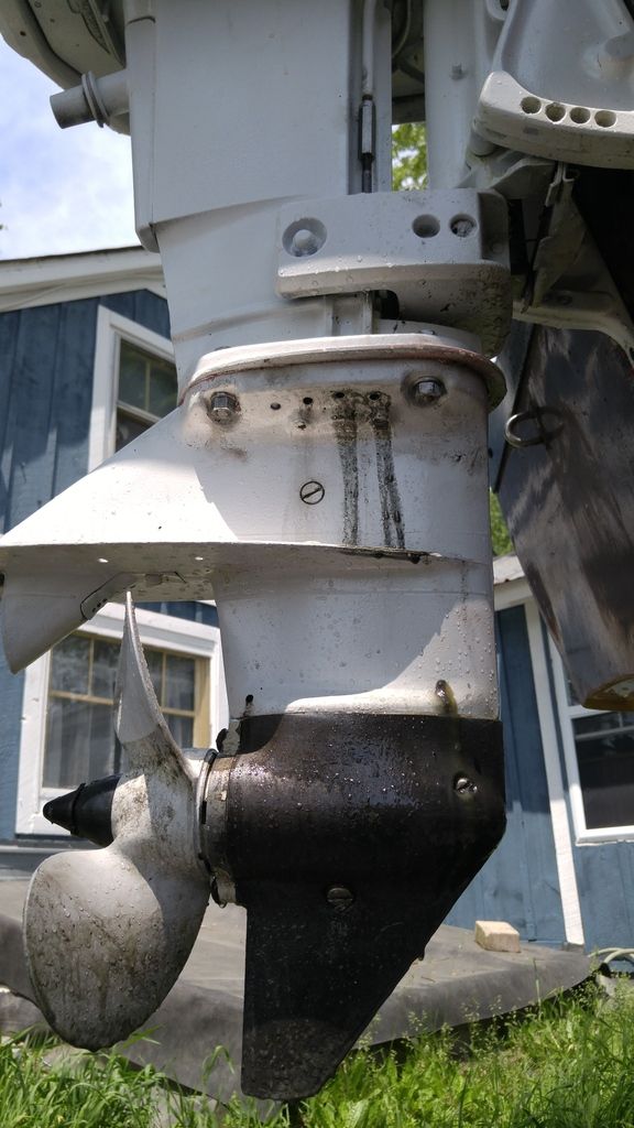

Runs good after idle. Pumps water. But now my problem is its too short for my boat. I didnt know the water inlet was so high. Any idea whats with the oil?

I have never seen that oil or ports (see my attachments. Could that be gas residue from sitting and something not sealing? Is that oil and heat making the L/U black?

The 35, 45 and 55Hp from 1967 and up till about 1976 are very very similar to each other.
They are from the same engine family and the differences are, 35Hp did not have the battery and magnapower ignition.
The 35Hp did not have an alternator (battery and magnapower ignition) and the bore was smaller.
Almost everything else was identical except for the props. But the gearhouse was the same.
The oil is unburned fuel mix (residue from idle). Twostroker do not burn all fuelmix especally at idle.
The holes are for draining the leg from water.
As your boat has a long transom and the engine has short leg this will not be a good combination.
At higher rpms and trying go to plane it will cavtate. The engine will rev up and boat slow down and start "kicking" because of cavitation.
You have to go for a long leg engine.
You can convert your with an extention for the midleg, long driveshaft, extention tube for the cooling and an long leg gearshift rod.

AH! Gotcha. Yeah, really weird they don't have an alternator.. I guess i'll post it on the local face book pages to see if i can trade it for something with a long shaft. Im going to play with the carb to try and get the idle kick to go away. Other than that it runs amazing. I didn't plan on driving the boat yesterday, just floating, but the water was above the water intake and the thing fired right off so away i went..
