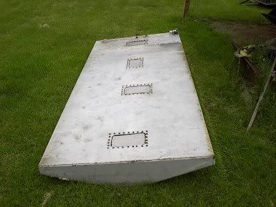

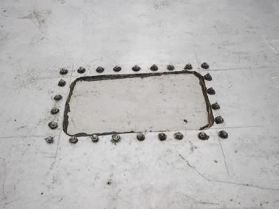

Hi Rick, When I first got my 27'er, It had lots of garbage in the tank. It was a 100 gallon one.<br /><br />I had to remove the tank from the boat. I cut 3 access holes in the top of the tank. The holes were about 8 x 10 inches. That allowed enough room to get in there and scrap up the excess trash. Then I used degreaser and scrubbed the inside until it was nice and clean.<br /><br />Now to cover the holes, I used 1/4" plate aluminum. I made them 12 x 10". I centered them over my cut outs and drilled holes about one inch apart around the patch. I then took the thick piece and threaded them with a tap. Redrilled the holes in the tank a bit bigger to allow my screws to drop through them. I made a cork gasket, covered it with #2 permatex. Placed the patch inside the hole and fastened it up. I'll post a few pics since I just recently took my tank out. I'll do that later on this evening. The pic will help make you understand my jiberish that I just spoke of.

Here is the pics of my tank. I filled it up with water completely. Marked where my clean out holes will be. Used a hole saw for the corners and a jigsaw to do the straight lines. Just make sure you don't cut into a center support. To hold the aluminum plate up into place until getting the screws in, I used duct tape to make a tab. Just be sure to fill the tank with water or otherwise you could go kabluey! It's been about 5 years since I did that job and it hasn't leaked or shows any signs of stress. The thickness of my tank skin is 1/8".<br /><br />
<br />
<br /><br />EDIT: I forgot to mention, I used #10 fine thread stainless screws. I got small Orings to fit over the threads of the screws. The Orings must be suitable for gasoline. I run the screws up through the plate first squeezing the oring againt the plate. I made a cork gasket, coated both sides with permatex #2. Put the plate inside the tank and pull the plate up so the threads of the screws go through the holes in the tank. Put permatex on the threads, flat washer, and a selflocking stainless nut. <br /><br />This was the only way that I could see saving this tank do to the trash that was inside. I filled 3 2lb coffee cans full of crap. The gas was so old it was like syrup. Nasty smelling stuff. I don't know if this would work for your tank or not. Good Luck.........SS
