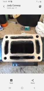

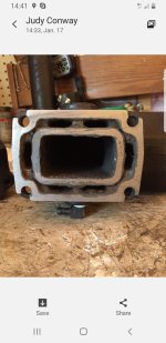

Up date, here are my riser and manifold after getting them back from the machine shop, photos of before are in previous trends. The guy told me to use gasket sealent, but I have the orgional gaskets coming from volvo, and I taught those were to be installed dry ??? Any input would be welcome.
Thanks to all in advance

If those are the metal Volvo gaskets I recall reading that they said to use a Permatex copper spray sealer on them. See what the instructions say.
Cheers
Don B
Dry gasket method in the industry is derived from installing using too much gasket sealant.Diy"s ,techs,boatyard mechanics etc... Everyone seemed to apply TOO MUCH sealant and when the riser was tightened down,the sealant was squeezed into the passageways and created coolant restrictions in the passageways.This is the main reason manufacturers recommend dry gaskets.This is exactly what I was told from a Mercruiser rep.I use spray " Hi Tack." made by Permatex.It is a gasket sealant that is aerosol so you cant over apply it.There is nothing wrong using a gasket sealant as long as it is not OVERAPPLIED .Years ago when I spoke to a rep from Mercruiser corp,I was told to apply a very thin bead of sealant on both sides of the gasket and install the riser without tightening anything.Wait at least 24 hours before tightening down .this allows the sealant to firm up into a flexible solid that will create a proper gasket seal similar to an o-ring.The rep told me that they dont recommend using sealant ONLY because everyone uses too much sealant.Using sealant is optimal but only if the correct amount is used and tightening down takes place AFTER the sealant has cured.Charlie

I used Permatex Aviation as per what the Barr Marine tech told me. Worked out fine 4 seasons later no leaks.
Thank you Charlie, what you say sounds reasonable and makes perfect sense, I will be using some kind of sealent, thanks so much for the infomation, find bunch of people on here and so much knowledge
