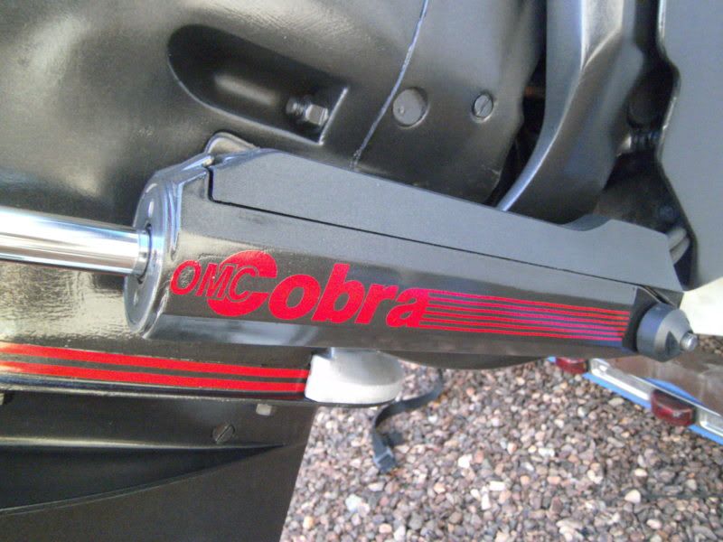

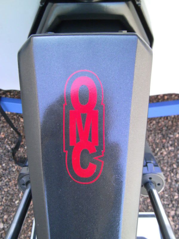

Just finished up the resto on the outdrive... what do you think? I am currently redoing the flame arrestor cover, will have pics tomorrow

Re: Cobra Sterndrive resto
Looks brand new! Great job. I would do this to my stringer, but it wouldnt match the worn down look of the rest of my boat and I would feel awkward. :)
Idlespeedonly
Jun 30, 2011
779
Paint looks really good. Those ram stickers look good also. What kind of paint did you use?
wcasey5
Feb 27, 2012
197
Where did you get the decals? Looks great!
Reinell-BRXL-191
Apr 18, 2012
295
I used Moeller OMC Cobra 25479 engine paint
After looking all over, I realized the liqui-domes were no longer available, so I cadded them out and made them myself on my plotter

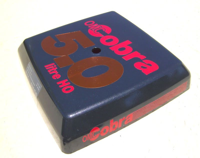

Just finished the flame arrestor cover- turned out really good as well
