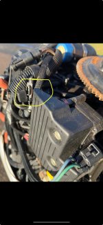

starting a new thread because I think it’s a new issue. Model number and pics for reference posted below
I have. 2001 evinrude that just got a new/used power head installed. Ran great before connecting it.
Took it to the boat ramp it started and I got it to the dock to park my car turned it off and when I came back to crank it I kept blowing the fuse going to the PDP at key on. Found it was a loose wire to the pdp and then it now cranks again. I charged the batteries up, they’re brand new. And it just continually cranks. The rpm gauge flips in circles which was weird. In desperation mode I used starter fluid and it still only cranks without turning over.
Any ideas appreciated

Ok hooked up a jumper and it ran. Noticed positive terminal is pretty corroded. Going to try cleaning that off and seeing if it is going to end up being a quick fix

ok lets clarify which wire surprised by your finding checking all wiring was the first step ! no ?
