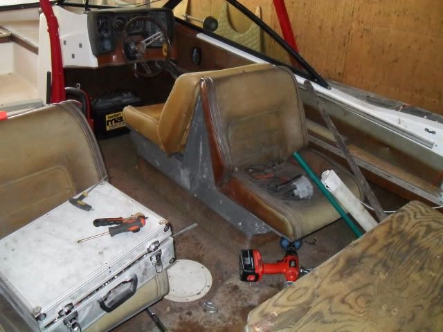

I am changing the seating layout on my current project from back-to-back lounge seats to two buckets seats and a bench.
I like the style/shade of the seating part itself. So I would like to convert to single buckets on a swivel with a storage box under each seat.
Has anyone done this before? If so how?
Old seats:
I am thinking of 3/4 plywood for the base and back support and 1/4 plywood L-shaped bracing (matching the contour of the seat foam)
Then vinyl sprayed to whatever color I want :D

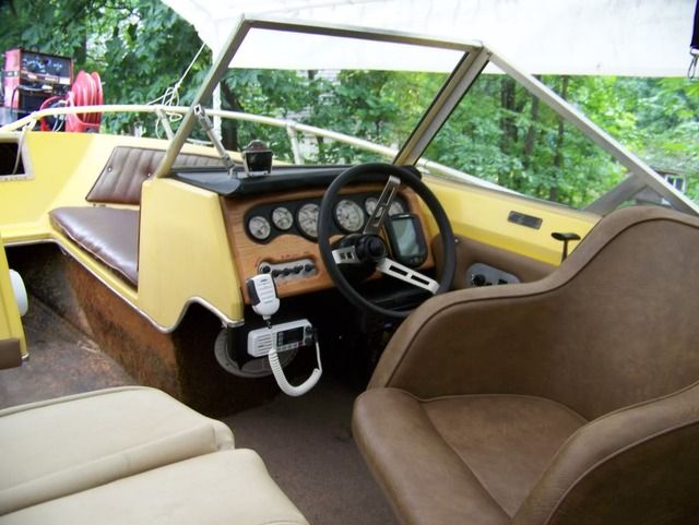

I just made a box out of "1/2 ply glassed to the deck and put a locking RV hatch in it and mounted a Wise helm seat with a swivel on top

No pics of the base, basically built an open box turned it upside down and glassed it to the deck. I'm using a back to back on the port side.
I took out the aft seats out and built a sun deck across the back

Is the swivel point rearward on the seat base or in the middle? I don't want the seat rub the side or touch the throttle lever.
Thanks for the photo
I had originally built the box for a different seat, it centered up perfect. The new seat was a birthday present from my parents :D
The seats come with mounting points built into them so you can't easily change them. I had to offset the seat on the base to clear the throttle. I'm sold on the swivel, much easier to scan these busy waterways.
The next one will get the slider with swivel
