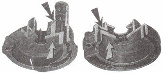

does your pump have some kind of relief vent hole that if blocked can impair the pump,s operation.. not saying yours does but check anyway see warning on older style impellers
you replaced the impeller (original) does that mean you replaced the "original" impeller or does it mean you used an " original" like OEM vs chinese
some cheap impellers have been known to separate from their brass liner !!
did you apply sealant on the rims of the stack of gaskets and plate ?

I do have the vent hole but it wasn't clogged. Installed new factory OEM impeller.
