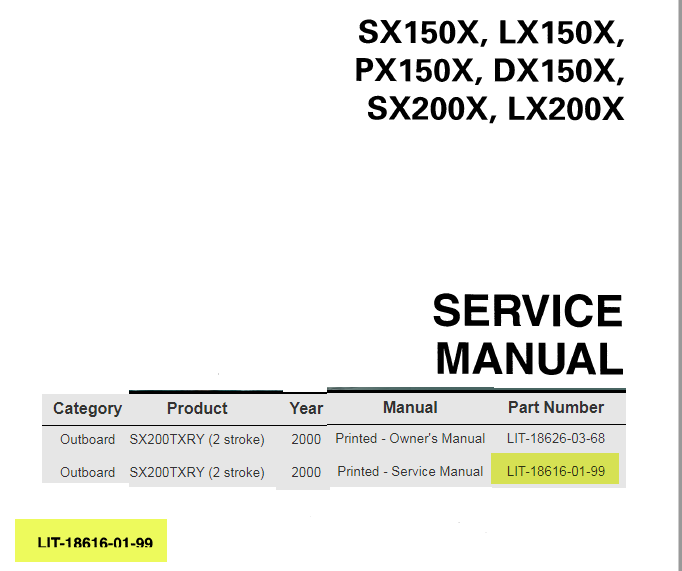

Hey Boscoe,quick question...Where did you get that spark plug info from??? I picked up the designated plugs with your info back then and now Im getting around to changing them out and when I doublechecked I saw that the plug it calls for is a BR8HS-10 , the 7s looked like there were for a smaller motor? do you remember where you saw that?? Thanks Charlie

Information comes from the Yamaha service manual and owner's manual.
Thanks ,but what I was asking is where you got that particular info from?
I recently bought a service manual and it calls for BR8hs-10. Just wanting to know where you saw it? Not sure I am comfortable leaving those plugs installed and I literally just installed them right after cranking up after winter storage.Charlie

was that a Yamaha service manual or an aftermarket one?
Boscoe said the Yamaha service manual and owner's manual
What is the document number for your service manual? This is what I have seen.

I got the plug # from Clymer manual and from the designation from SIM Yamaha.I looked at the plug specs looked to be the same except for the heat range the BR7 is a 7 and BR8 is an 8. Not sure it matters much??? Charlie
Thanks again,I guess either plug will do.Here is an answer directly from NGK..
Hello Chas,
Thank you for contacting us! NGK 1134 BR8HS-10 Nickel Spark Plug is the recommended part for your 2000 200hp Yamaha 2 stroke outboard model SX200TXRY.
NGK 1098 BR7HS-10 is 1 step hotter.
Best Regards,
Murphy
