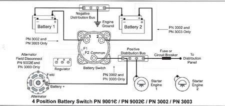

If your not running a battery isolator, you should. An isolator will help your alternator live longer, will charge the battery with the lowest state of charge first, keeps the alternator from overcharging a fully charged battery, and also keeps the alternator from under charging your batteries.
Here is a couple of typical two battery setup diagrams.
