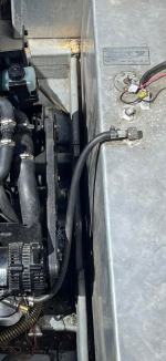

1994 Crownline 250crIMG_1700.png94 Crownline 250cr. Cannot figure out how to get this gas tank out. The engine has been removed. All the fasteners around the tank have been removed and it slides freely ,no room to tilt back and obviously the plywood across the bottom stops it from coming out that way, the only thing I can assume is the plywood firewall behind the tank must be removed from inside the boat and taken out that way am I correct? Thx for any help!!

since you have the motor removed, get a pic from the transom forward (you can take a pic thru the transom shield) should be able to lift and pull

There’s only 3 inches or so of clearance before it hits the top. It needs to come up at least 6 to 7 inches to clear the plywood on the bottom. If you slide it all the way towards you and try to tilt it forward there isn’t nearly enough clearance.
I can’t help but wonder if they didn’t put the tank in first and then add the plywood across the bottom afterwards?

Tanks are always installed first then the deck is installed.Your going to have to cut out what ever is in the way and rebuild later
I had to cut out the Aft cabin bulkhead and deck above the tank

Like alldodge said, the tank was set in place, then the hull set on top of it. That also goes for pretty much everything else. The hardware is installed while the cap and hull are apart.
