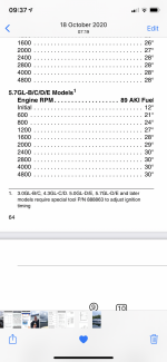

Need a little advice on delco est as there doesn’t seem to be too much info online. Delco est on mercruiser 5.7. From my understanding it is supposed to be running at 21deg at 600 rpm. When I install the shunt to set initial timing at 12 deg the timing doesn’t lock and when timing set and shunt removed it doesn’t jump back to to said 21deg (stays where I set it at 12 deg witn the shunt). With the engine running and the shunt connected to 12v the module doesn’t seem to want to lock into service mode. I have tried a new gm module with the same results. Am I missing something? Thanks 8E6D639D-28D1-42D6-AD70-FF564EC790AB.png

Your in the Merc section, talking about a Merc 5.7 but show page out of VP

Is this a genuine setup or aftermarket? If genuine, give us an engine serial number and we can give you the full info.
Repower engines that came with these as new. Merc 5.7 blocks mated to vp 190 legs. I don’t know much more. Bought the boat with these engines and it’s never quite run properly. Tanks for the reply.

ok Merc reman and want to time it as a VP.
I have the same VP doc and also don't know of a EST module which will provide 20* of advance, most are in the 10* to 12*
To time the EST it gets 12V connected which puts it in base timing mode. The 12V shall not be connected to it with the motor OFF because it can damage the module. If the module does not go into base mode then its probably bad
This is a Meerc 3.0 procedure which can be used as how to
