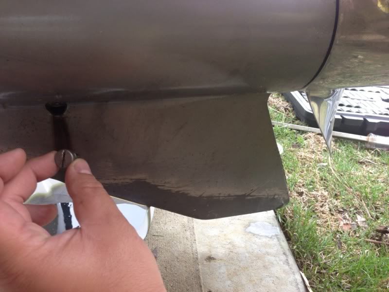

Next you will want to remove the drain bolt at the bottom of the stern. It is a flat head bolt. Make sure you have something underneath to catch the oil.

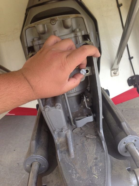

Next remove the fill flat head screw from inside the cover that you took off. This will allow the oil to drain easier with air flow.

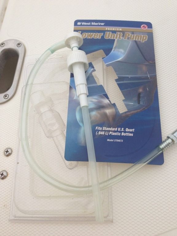

Once that is done then you want to pump new oil to the top. I have a oil pump that you screw in to the bleeder bolt at the bottom to pump the oil up. Any marine store will have this and I even saw walmart had it.
Start slowly pumping oil into the stern unit slowly. Do not pump too quick or you will get unwanted air in your drive. You will continue to keep pumping and adding oil until it flows out of the middle bolt you took out from behind the cover. When you see oil coming out this means it should be full.
