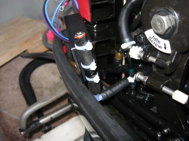

Here is the oil feed line going from the oil pump on the right to the check valve on the left
First I cut the oil feed line and installed a Tee fitting
It?s important to bleed all the air out of the oil lines so that the Oil Watch Monitor can accurately sense pressure pulses. In this picture I have plumbed the Oil Watch Monitor, but I have it rotation upside down on the Tee fitting. I then stuck a nylon 90 degree elbow on the exit side as shown
To purge the lines of air I started the outboard on a 50:1 premix and ran it until oil was pumped out of the line. Actually, my intent was to run the engine until oil pumped out of the line, but the 90 degree elbow was translucent enough that I could easily see when it started to fill with oil and I cut the engine before any oil pumped out. I was surprised at how slowly the oil moved through the line.
After I purged the oil out of the lines I replaced the 90 degree elbow with a plug. The plug looks like a hack job from this picture, but it?s a little more polished than it appears.
Finally I rotated the Oil Watch Monitor about the Tee fitting to it?s proper position and applied a hose clamp.
Here is a view from the top
The only remaining step was to make the electrical connections so that my existing warning horn would sound if oil pulses are not present.
In actual use the warning horn sounds when I turn on the ignition, and goes out when the engine starts (actually, it usually goes out while cranking). I?ve tested the function of the Oil Watch Monitor by using the lanyard kill switch to stop the engine while the ignition is still on, and as soon as the engine stops the alarm horn sounds.
