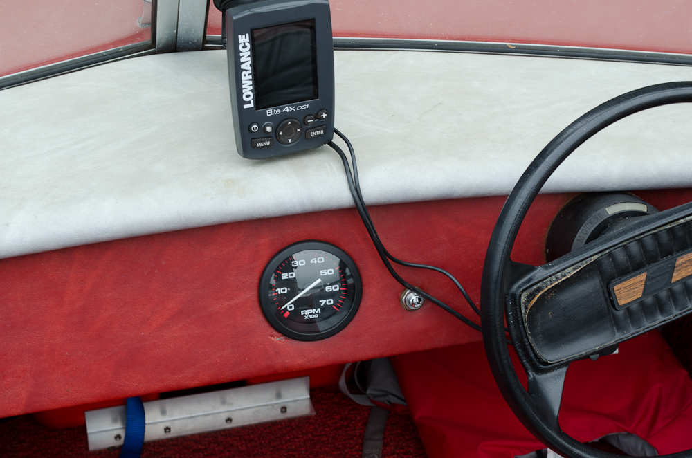

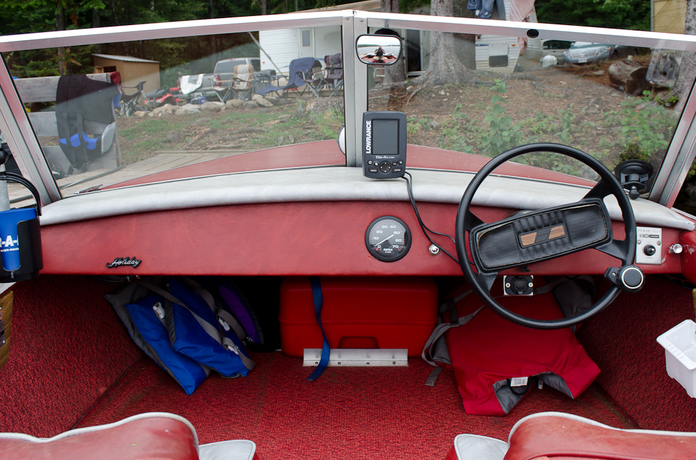

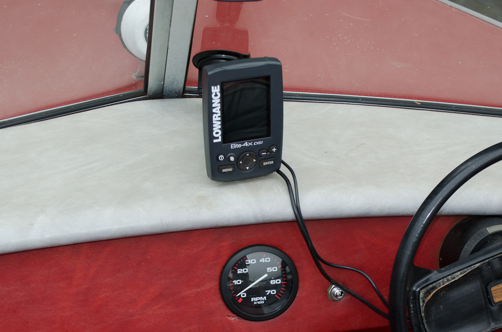

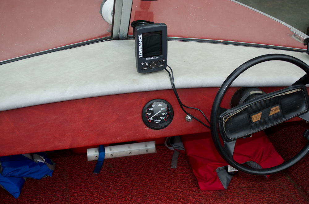

Re: Does anyone know if this Tach will work with my boat
Got it installed.
Wired up fine. Correct setting was 6P
Here are some pics:
Looks good up there Bill! The red accents pop-off nicely!
