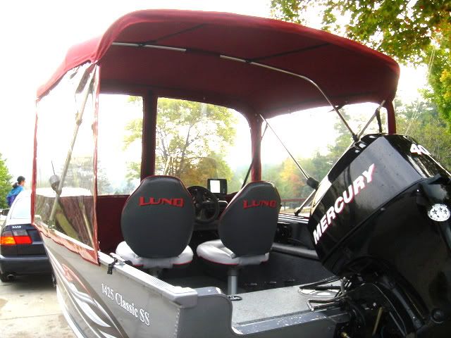

Yep, I went the same route as nlain.
The local canvas shops that a dealer recommends is a good way to go.
But it's not cheap. I used Sunbrella which is top of the line. But even if you went with a cheaper fabric it won't save you all that much because it's mostly the labor of sewing in all the zippers and cutting the fabric and plastic windows and then sewing all together.
My rig measure 14.9 inches and I started with a bimini I bought online and still it cost me $700 for the front window and the two sides that the local canvas shop made up. And that was 3 years ago.
It's pretty heavy, so I don't think a 2 bow bimini frame is enough to support it. The canvas shop can add another bow to what you have now if it's only two bows.
