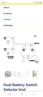

This is the unit I have. I don't understand the alt going to common and then the arrow. I'm a horrible electrician please help

I have no idea why they show an alternator connection right at that point. On all MerCruiser wiring the alternator connects to the main lead post on the starter solenoid, which is electrically exactly the same point as your diagram anyway...

On most inboard engines the common simply goes to the large positive terminal on the starter solenoid & there is usually another wire that goes from that terminal up to the B+ terminal on the alternator. If yours is wired this way then no need to add additional wiring. That Cole-Hersee switch is an excellent unit, very well made.
