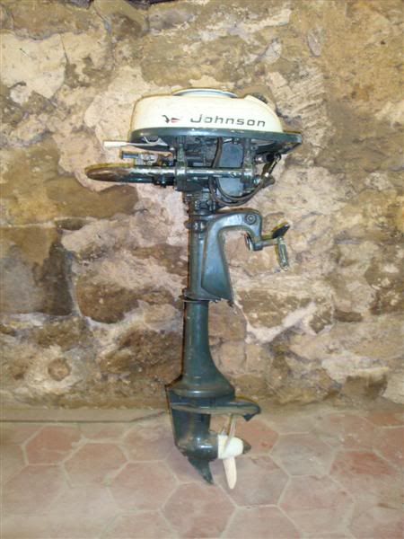

Hi - Anyone know what this might be? Thanks in advance.

I know for sure it is a Johnson. Other than that I can't help you much. Looks like a weedless prop and has similarities to a 4 hp but I really don't know. Best of luck. What is her asking price? Rick.

If the fuel tank is the original one,then you have a 1965 3hp engine although the lower cowling is missing.
Up to 1964 the horse emblem was above the lettering,while in 1965 it appeared on the same line as the lettering.
In 1966 the shape of the fuel tank was changed a bit
http://www.old-omc.de/j_1965/seite_06_07.jpg
Somebody help me here. I think that the 1965 3 horse did not have needle bearings and that it still needs to be run with a 1:24 mix

The engine is the venerable 3hp style and the color looks like the 1968 green. That was the last 3hp and it became a redesigned 4hp in '69. 1967 was a lighter green color and the earlier '60's models were French Silver which was a very pale gray shade.

It is not a weedless bottom, it is a right angle drive (JH series). The tank doesn't match the rest of the motor. And I don't know what kind of contraption that is bolted to the side of the powerhead.

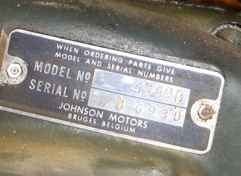

Someone else has suggested that it's a 1969 Belgian-made 4hp, series 4B69B. Does this ring any bells with anyone? Thanks for all the input.

Well, actually there is such a thing as a 1969 4B69. That would make sense if it were made for the European market. Never saw anything like it here in USA. I'll bet Enrico in Italy will respond to your aomci post.

OK, I think I've nailed it down. Searching on '4B69B' I found some pics which are exactly the same -
So it seems to be a 1969 Belgian 4hp. One of the attractions of keeping an old Johnson going is the pretty good availability of parts so the question arises - is this mechanically the same as the USA 1969 4hp? Anyone know where I should go to find out?

Wow, hadn't seen that version before. Many of the European and Asian versions were built specifically for those markets and were not made in the USA.
I'm guessing that the common service parts are the same such as carb or ignition. You may need an experienced tech to look at any parts you need to see if they are the same, as a person behind the parts counter may not have the listing for that particular motor since it wasn't a US product. They should compare using a regular 1969 4hp parts breakdown.
