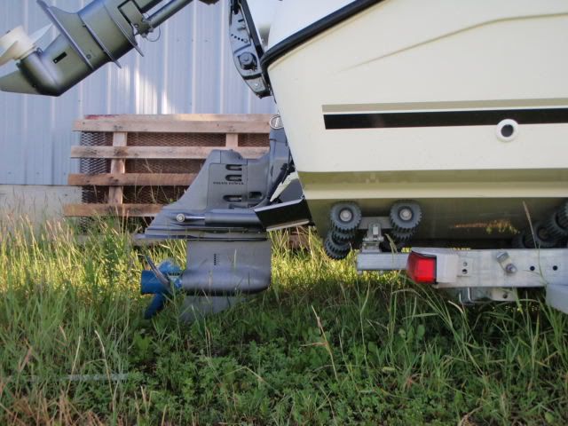

This link below I hope will work. It goes to photobucket where I have uploaded a couple pics of the boat and some videos. The video called "best view" clearly shows the problem and was filmed at midrange speed.
The stern view photo shows old aluminum prop and a depth sounder transducer which I have totally removed favouring a shoot-through-hull mount inside the bilge.

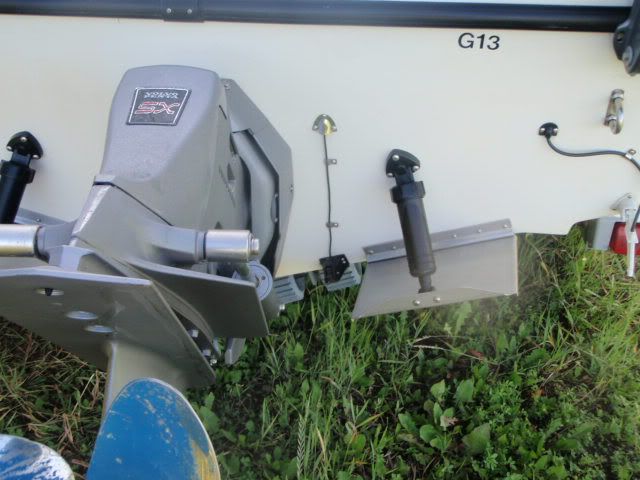

As to the Rooster tail that is a pretty busy transom..you tabs are more than likey to be the cause..I take it you tabs are hydraulic...8" from your drive is really a bit to close another very good source of a tail and could cause a lot of turbulance in the water flow when your launching ..not good
As to the drive height it is just fine..Question on those tabs...are the flush with the bottom of the boat when there in the up postion..that is the hull and tab bottom are like on flat line no bumps aka .....................____________-----------Dark line tabs broken spaced line hull..If so not good.
Your tabs will fuction at there best in a postion somewhat like this.....
Heres a pic of another volvo drive sx notice the cav plate at the bottom of the vee same as your's
Id drop the tabs get a donor 17 pitch and see if you cant get to 4950 rpm that is the electronic rev limiter..
I just took a peak at your vids, your tabs are dragging which is not good and you are not getting to much lift with that Enertia....a Stilletto 4 blads bay pro 11 would be a great choice for that boat.But first you need to resolve those tabs...further outboard and flat with the hull and when full raised they should leave no foot print in you wake at high plane.

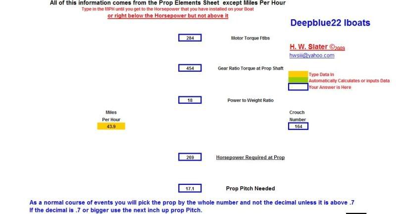

Blue, in my opinion you need to be running a 17" pitch prop with the load you carry at times, and if you are going to be running at 2,000 elevation regularly. The 19" enertia only has a prop slip of 11% , even with the heavy load you are carrying, so in my opinion it is not doing bad at all. I will show you my numbers and how I got there.
Boat and Motor
Prop Picker
I will let Dhadley tell you what he recommends for the best prop for your boat and motor, as he has much more qualifications in that area than I do.
