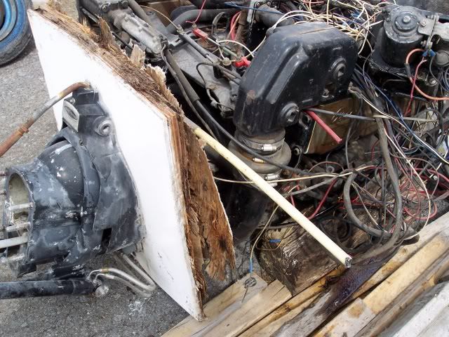

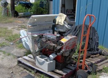

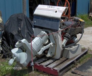

Thanks Don S. for the shots. There's nothing like a picture to help plan out a job like this. My engine didn't get submerged, only sprayed with salt water once and it was not washed off at the time. So, the engine is fine, but it just looks awful and I want to give it a good cleaning while checking out all the various bits and pieces. For what it's worth, there seems to be more opinions against putting an I/O in one of these dorys as opposed to an outboard. However, others who have them say they work fine, the boat is well balanced, it can be worked on by most folks and as long as you are vigilant with maintenance and upkeep, it should be fine. So, we'll see.

I had another person make an interesting suggestion, which was to cut the transom wider and install the whole affair into the new dory.
That sounds like a hack job to me. Trying to get things at the right angle, with the X dimension in the right place, and all perfectly square, would be almost impossible. Plus the fact that the old transom is probably rotten as well.
If you are going to do it, build it to fit the boat, then make the cutout. Full size paper templates are still avaliable from Volvo for about 5 bucks or less.
If you have a drive similar to the one I posted the picture of above, then here is a pdf file of the cutout template. At least you can see what it looks like. But the full size is the way to go after the transom is built.
