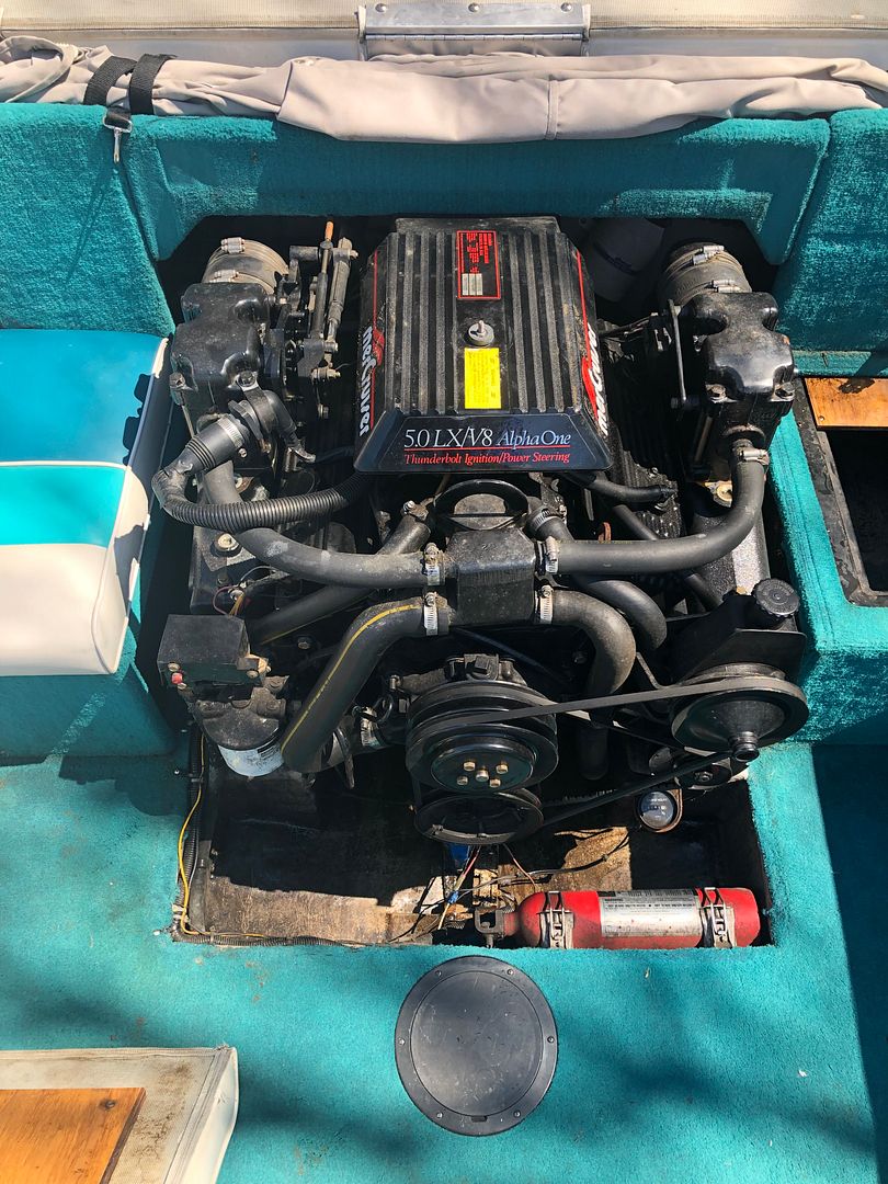

A wee bit of advice - The fire extinguisher under the doghouse isn't a good location. If you ever need to use it for an engine fire, are you going to reach into a ball of fire to get it? And if the motor is running, a panic situation isn't a good time to sticking hands and fingers near spinning pulleys and belts. It looks like it should be checked to see if it's still charged, too.
Back to your toothless splines.

i actually have three other exitinguishers on board, the last owner went over board. Two of the floor are still charged in good. I haven’t checked the other two. i will check the one in the motor to see if it’s even good anymore.
Is the coupler hard to replace? I’m assuming I’m have to pull the drive?

Looks to me as a halon extinguisher, has a heat sensor to set off

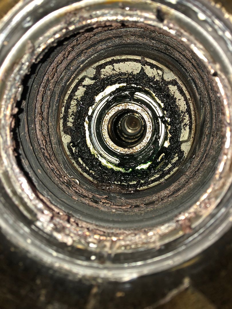

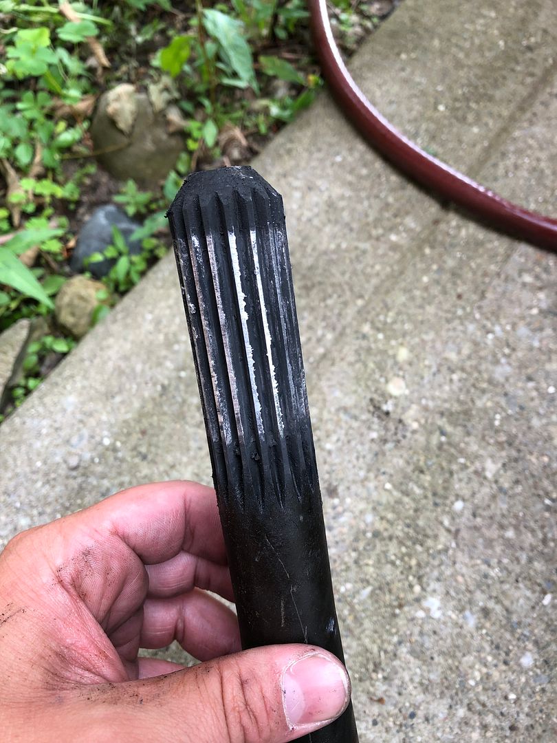

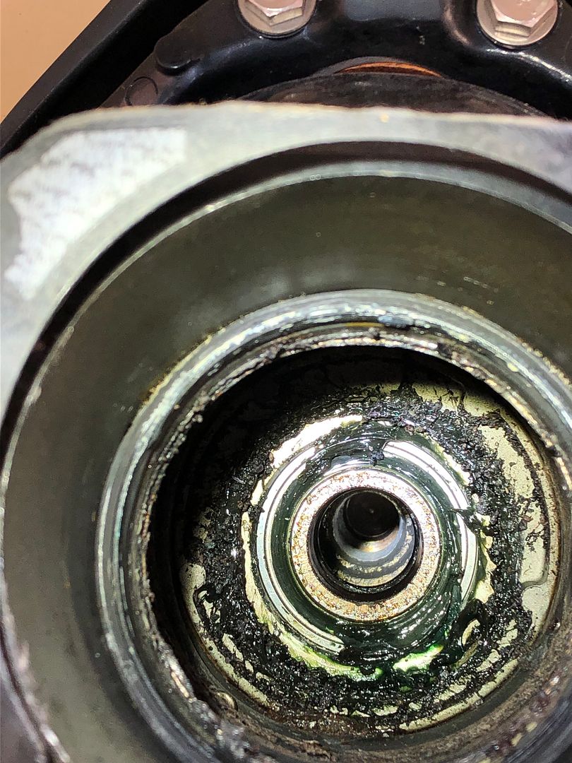

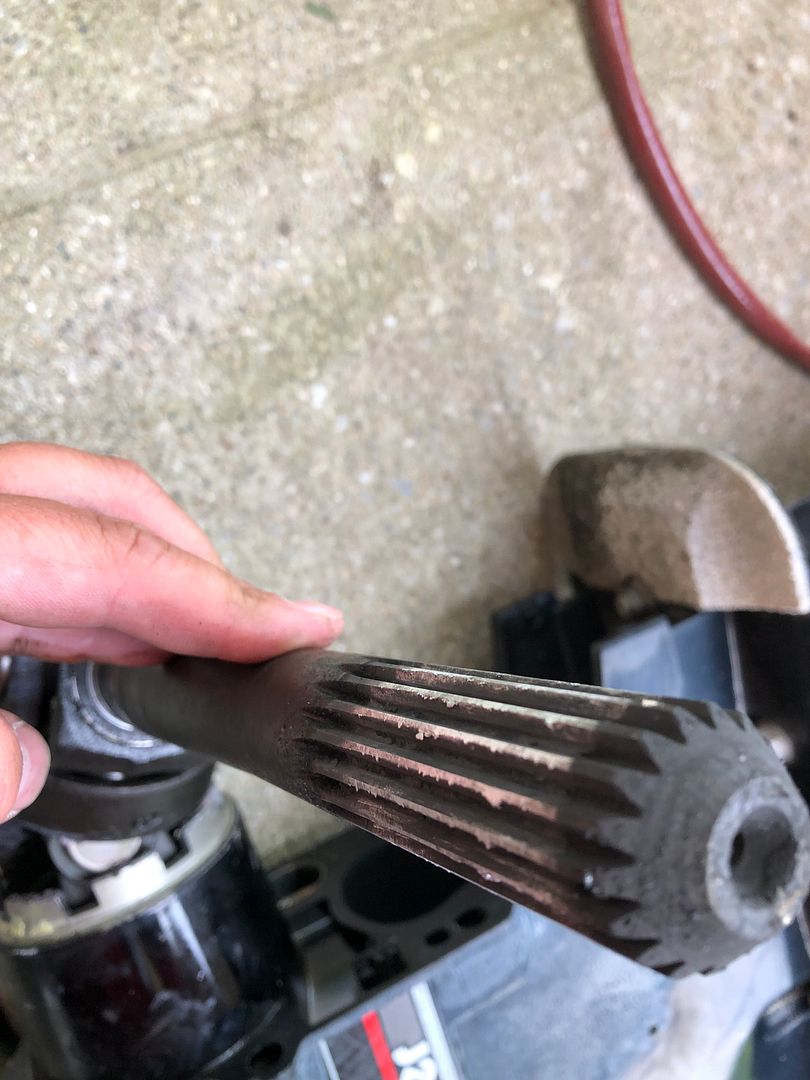

Well i did some research today and found out the drive is incredibly easy to remove. I had mine off in about 5 mins with no issues. First time ever removing an outdrive.
Unfortunately it looks to be the engine coupler. There were no noticeable shavings but the shaft teeth you could tell have been rubbing metal and there was no teeth inside at all and you can tell where they were rubbed down. I tried to get a photo. The gimbal bearing looks fine and spun free. The u-joints also appear to be fine. I am goin to call some local shops and see what kind of pricing i am looking at for a shop to do it. I do have some family and friends willing to help me replace coupler if shops are too expensive
On the way down to the lake we got in a wreck and the boat shifted forward about a foot on the trailer but did not cause any damage to the boat that i have found yet. Do you think that cause the motor to get out of alignment? Or was it probably me hitting the prop on the sand bar?

In most all cases the coupler goes slowly over time from lack of maintenance. The drive should be removed every year or at least every 2 and inspect it, change fluid and check alignment. Yours hasn't been done in a while so it just gave up.
The wreck didn't help but should not have changed anything, but the sand bar probably finished the job, due to it was so worn at the time

Doesn't look like that drive shaft has much grease on it...when was the last time it was off/serviced?
