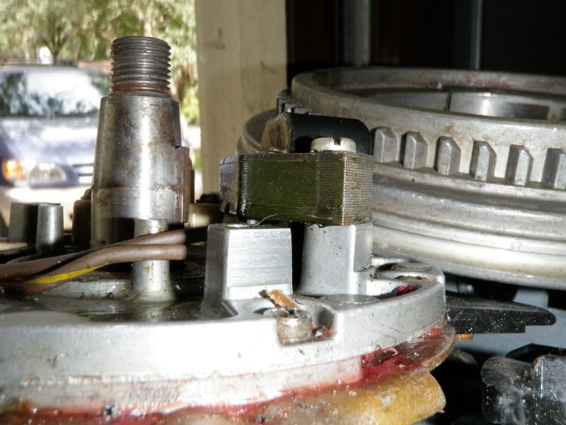

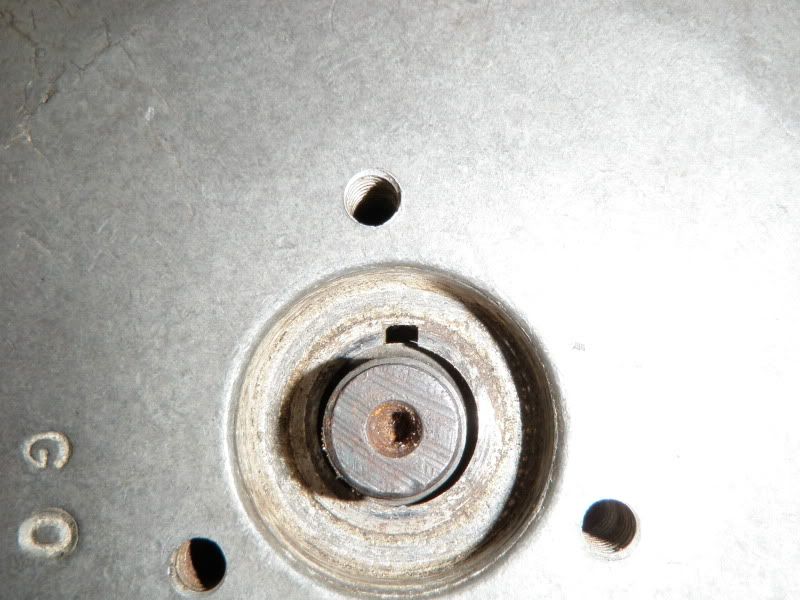

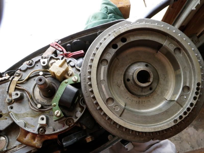

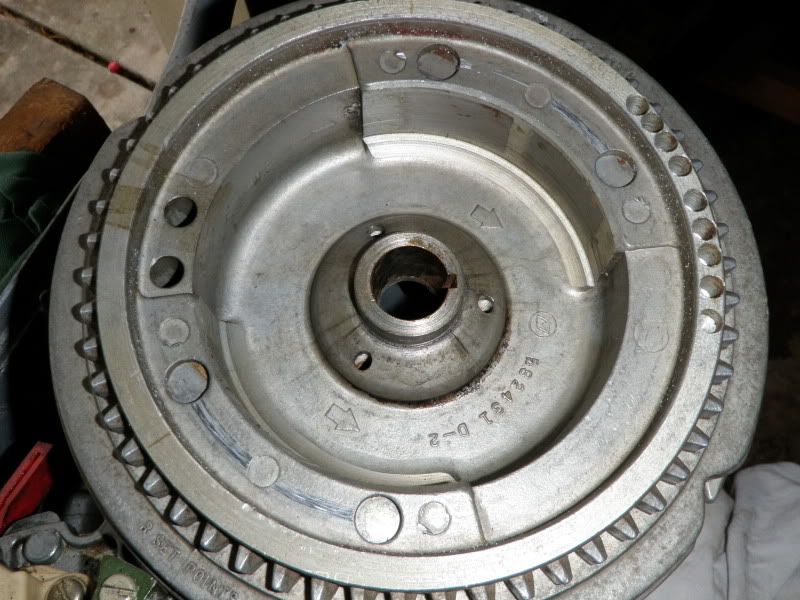

Here are some pics with the key and flywheel. anything unusual?
thankyou

Re: Evinrude 1983 15hp. Motor hit Shallow bottom
Flywheel and crank, key and keyways are fine. Since your problem is an idle issue, meaning it dies at low speed, suspect something go jarred loose by the impact. I would pull the carb and check it. It may well be the low speed circuit and jets are obstructed. Check compression too as it's an easy thing to verify. Have you tried changing the spark plugs?
