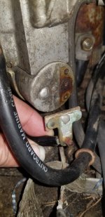

So I was pulling the carburetor off to rebuild it and the power prong for the choke solenoid broke off when trying to get the bolt off. Guessing there isnt any way to fix this? Gotta get a new solenoid right?

well only you can tell if you can rewire it up (solder whatever) JB weld it back maybe ??
can you take it apart ? solder and reassemble it
MCGiver would fix it :)
39,235
There should be lots of those solenoids available used.-----Visit ---aomci-----E-bay-----

Well I tried to solder it back on but there just isnt enough room or enough of an area to make the solder truly hold with the equipment I have. Guess I'll just try to go buy a another.
