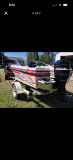

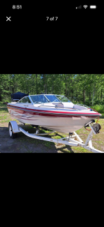

Here’s some pictures of a smilar hull. It’s not my boat pictured.
