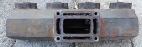

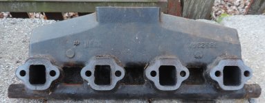

Here is the manifold before and after. Took about two hours to do.

Well $750 or it can cost you a lot more down the road.
Monitor the manifolds they rust and get pin holes. Next thing you know you have water in your cylinders.
I tried to stretch mine this year and ran into that issue.

You can test manifolds by filling the water passages with Acetone and watching for leaks at the exhaust ports. Careful though because it’s quite flammable. It has lower surface tension than water so that’s why it may show leaks where water won’t. Best done with the elbow removed.

Most of the issue is the sealing surface - they can be filled with acetone and leak tested while off. Acetone will wick into pin holes and cracks and show defects that may not show on pressure test or water filled test
Mine wasn't leaking at the gasket and the passages looked very similar to the OPs. $750 is nothing in the boating world and better than having a locked up engine.

to the OP if the sealing surface is good and they pass an acetone test you will not have an issue. In salt plan on replacing every 5-7 years. Inspect every year or two.

In the fall I'm going to replace my elbows because by then they will have been used in salt for 5 seasons. The manifolds I will inspect the sealing surfaces and acetone test. Then evaluate. So far no signs of leaks either outside or in cyls. I have a local dealer where I can buy Barr Marine aftermarket exhaust so I don't have to pay for shipping ($$$ with exhaust because each side is a bit over 40 lbs). Also when I've replaced manifolds etc I take em to the scrap yard, you'll get about $10 for about 80 lbs of cast iron scrap.
Just did a compression test a few weeks back so I'd have noticed if there was water getting in a cyl.
BTW, I think it is a good idea to do both an oil analysis and compression test at the end of each season. That way you know what's happening with the engine and if there are issues you have the off season to rectify it, and not lose time during the season.

Acetone is a good way to test although sometimes small defects become more prevalent with heat
