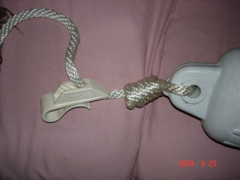

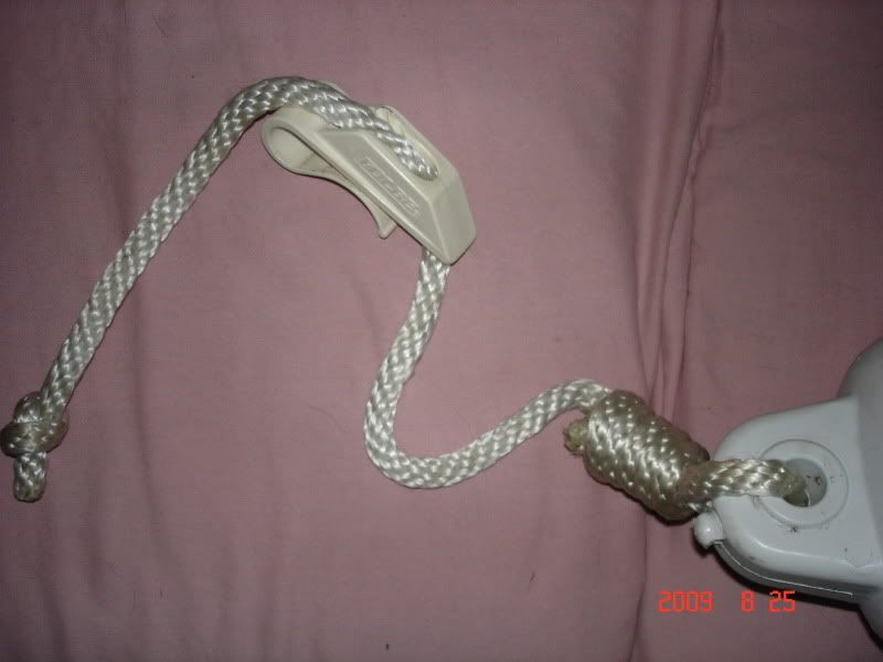

Best thing by far I've found for attaching fenders to my LPX are these Folbe "Quick Tenders". I use a lot of different docks, and between the tides and the different types of construction they're always at different heights.
http://folbe.com/index.php?main_page=index&cPath=5
I tied my fenders on to the lines with nooses, it's probably not the politically or nautically correct way to do it but it looks good and works great for me!
I've tried a lot of the alternatives. My boat has the hidden cleats up front, in the middle, and in back. They're too low in most cases.
The previous owner of my boat had screwed the little eyelets to the side. I tried using them, found that the only good thing about them was the practice I got matching the gelcoat when I filled in the screwholes! Jim, DO NOT screw anything to the side of your boat!
The quick tenders let you instantly adjust the height of the fender. Tilt the rope to the outside, slide it to the right height, then tilt it back in and the grooves lock it down. The clips fit over the windshield, the bow rail, or the cleats.

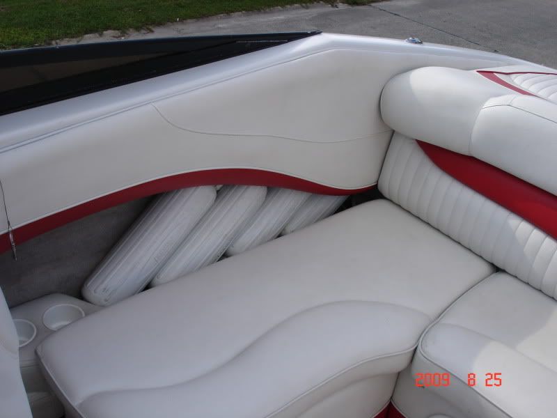

4 fenders with ropes and Quick Tenders store very nicely inside my boat. I hang one at the back of the windshield, one at the front corner of the windshield, and one off the bow rail. Usually don't need one at the very front near the point of the bow.
4 fenders on boat:
4 fenders stowed beside seat:
