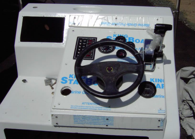

Look what I did with Starboard It's a easy fix and looks nice......

Blulunch - nice work with the starboard. Looks factory!
BLU LUNCH
Lieutenant
Aug 8, 2003
1,316
Re: Filling Dash Holes
Thanks, I was happy with it the 32 year old console had more holes than swiss cheese....
