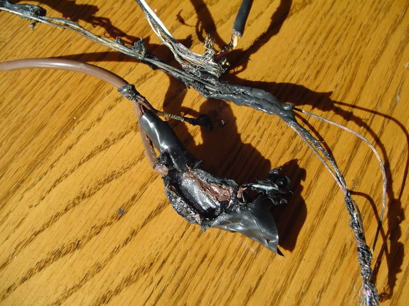

After a good day I was cruising back to the dock when I noticed the lowrance was off. Then I smelled smoke. Then I saw an orange glow underneath the dash over the passenger foot well. Fire? Fire!
I looked under the dash and saw burning plastic dripping from some wires. I stupidly reached up to pull them off and burnt my hand.
I then went to the rear and disconnected the battery.
Then I got a rag wet and smothered the burning cord.
I then saw a lamp cord that had been cut off and used to wire the lowrance. A brown cracked cord with two ends twisted onto the lowrance harnes. Not even tape at the connection. What a mess. The harness is melted right up to the unit. What a pile of hidden crap.
