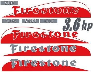

I'm looking for some good pictures of the 1950s Firestone 3.6 Outboard Motor By Scott Atwater or a brochure or something, and can't seem to find any. I'm fixing one up and I want to reproduce the decals. Any help you may give will be appreciated.

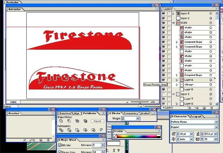

Thanks, I've been looking there but nothings clear. I'm making one from scratch.

You're on the right track. When you finish your decal replication, you can print it on water-slide decal paper (available online, including Schmebay), seal it, apply it, and clear coat it (use UV-resistant clear coat), OR you can find a good local graphics shop...like a place that does signs, etc., and have them make your decal set on vinyl. Much easier to apply and much more durable...cost is generally under $50...depends on how much vinyl is used. Keep watching the auction site...a decent photo will eventually show up there. When you paint it, remember to use a self-etching primer under the top coat...otherwise all your paint will just slake off after some time in the water.

Here's wahat I got so far
Maybe I should start a business:)
