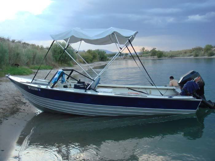

I went and measured my trailer for the boat I might buy. the boat is a 17' and my boat is a 15' but I was hoping to use the same trailer.
from the rear of the bunk to the front of the trailer where a boat's bow should be is 14.5 feet. I could probably squeez another 5 inches out of it, making it 15 feet. But i just dont know....
ideas?
here is the boat:
and here is the trailer:
