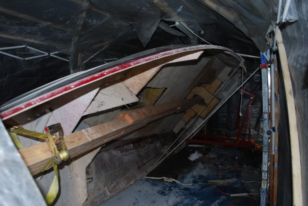

To flip 20' bowrider's hull i used home made gantry in the front (giving clearance to take the trailer once the boat was in the air) and engine jack in the rear.
I've bulit 2x4s to over 20ft in length extending 6" on each end.
Concept was to rotate the hull in the same manner as you'd roast the pig ;p
Ive reversed the bow eye to face inside to fasten front part of the boat.
In the rear i went though transom opening to get more symmetric center of gravity.
Once boat was lifted i got the trailer out. Using winch from trailer and extra length of the rope, I easily rotated the hull.
Few tips:
Using straps rather than chain around the main shaft helped the assembly to rotate smoother.
To constrain front from any movement while the boat is half way into the rotation (sideways), fasten short 2x4 piece to main shaft angled to bow line of the hull.
That was my take on it. I was doing the flip by myself.

DanielR ... good work. Now I may make a similar concept bolted to my motor mount area with a pivot shaft similar to a engine stand. The front I may make a small gantry to winch it up on and do a similar flip but my bow eye is not able to be flipped so I will think about other ideas. Sadly I had a nice gantry that I made camouflaged as a swing set attached to my kids two story play set. Of course the wife then couldn't believe it and later it did actually get converted to a very very tall swing set. Boy could I swing the kids up there. We had to buy some small parachutes for safety ... lol
