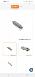

That is the closet that I can find on Crowley it is the same as mine without the rubber tip. Any suggestions on where to go from here. I've looked into buying all three new carbs and only ones I can find are way out of my price range.
