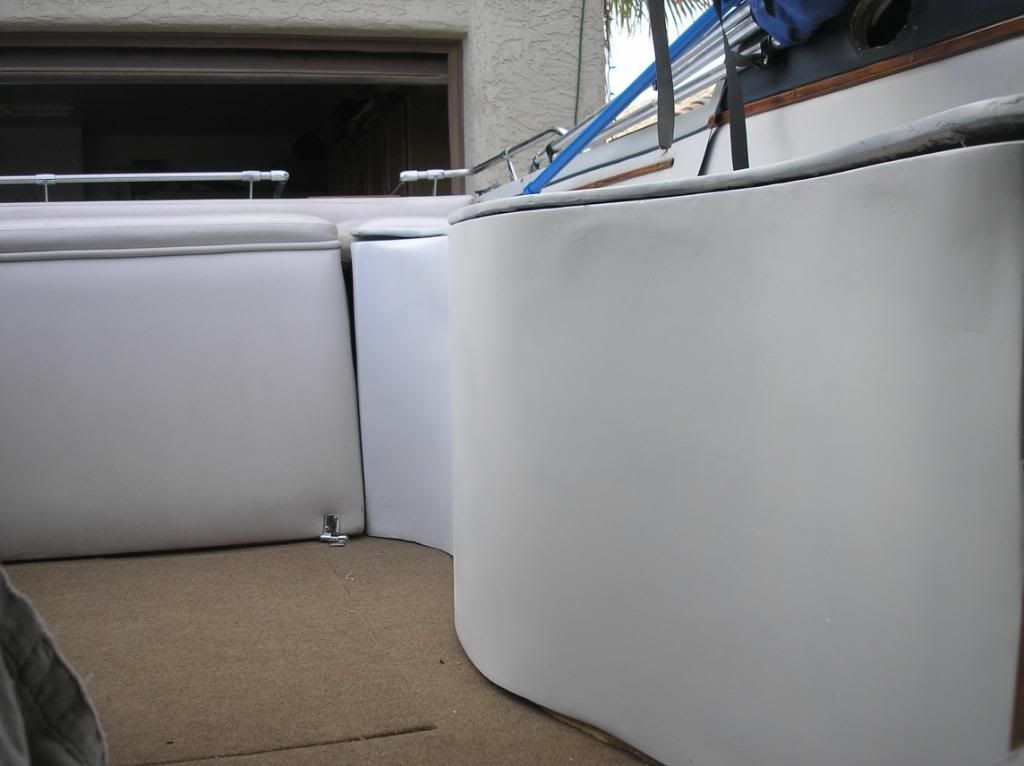

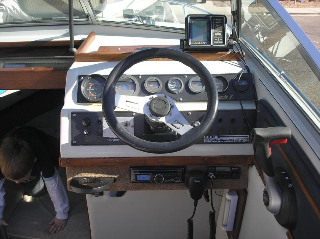

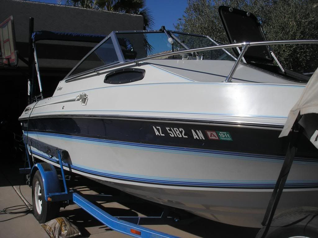

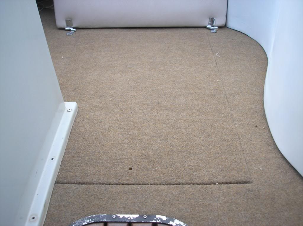

wuts up everyone it's been a while...gonna show you my progress...about 90% done...feel free to give me some feedback1.jpg4.jpg6.jpg11.jpg

90% complete

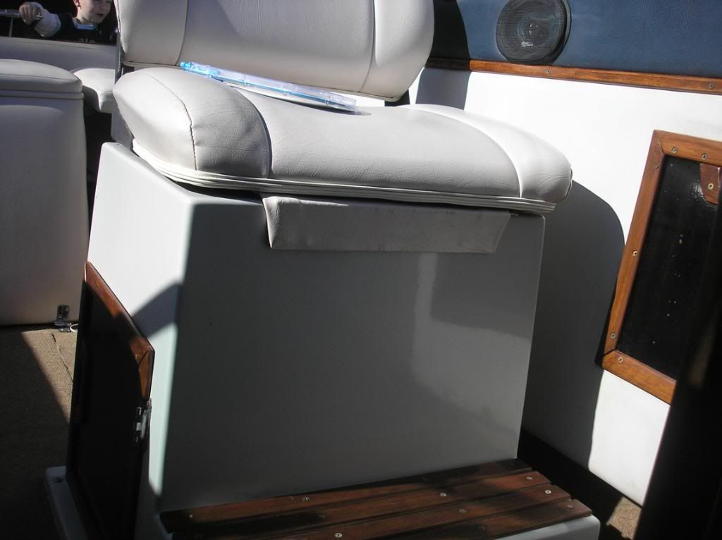

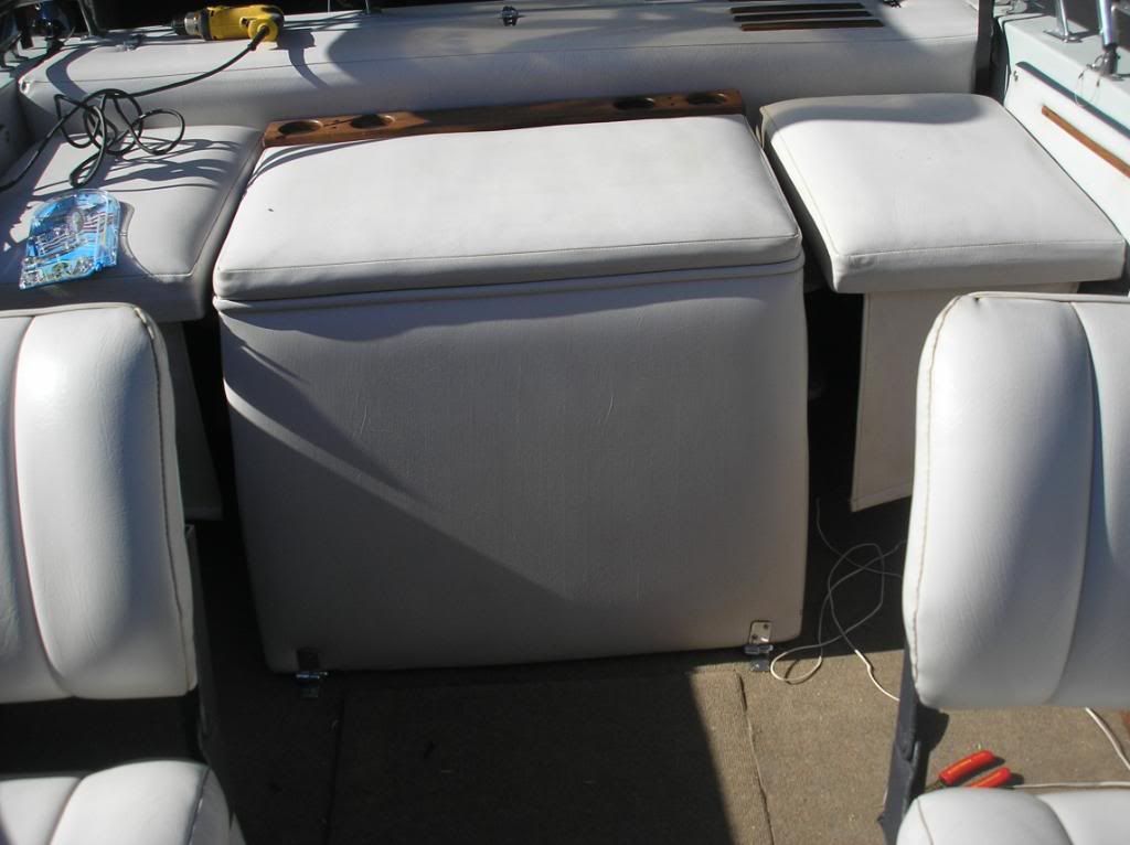

I replaced the decks in my "89" Mach1 magnum.
But I did the sun deck and motor cove a little different which gave me about another foot of floor space and I can put an one of the Igloo cube coolers under each rear seat. They are hinged at the front and it gives me a lot of extra space not having a cooler under footphoto.jpgseat3.jpgseat2.jpg
between the seats is a narrow bench large enough for kids and the bench seat lifts out so you can still get to the belts and check the oil.

tswickso....
that was a great idea, i like where ur heads at...i actually have 2 open compartments on each side of the sundeck with handles on hatches so you dont have to open the whole deck to access them. 1 has a sink which i use as a bait well/cooler that drains into the bilge, the other give me access to the batteries and such...ill post more pics
