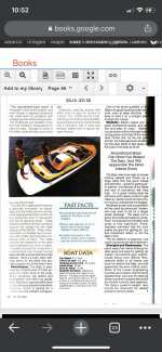

Hello, first timer on here. I have a 1990 Baja 200 SK that I am working on. It’s a Ski boat with a 5.7L Mercruiser V8 (Chevy small block) direct drive inboard. I currently have the engine removed and am in the process of replacing stringers and floor. I have the floor pulled on the passenger side and not the drivers side. I have removed the water-logged flotation foam and stringers and am planning on not adding new foam back. I don’t want this thread to turn into a debate on adding / not adding flotation foam, but I will entertain all thoughts. My question is: if I wait until next winter to do the other half of the boat stringers/floor, how bad will my weight distribution be with potentially waterlogged foam on one side and no foam on the other? This boat hull is relatively flat compared to most, as it’s a ski boat. Thanks for reading and I appreciate any and all responses! Thanks guys 00B8B924-9F2A-457D-82ED-319D2D99D64A.jpeg04BD593B-D649-4AB6-A99A-DE6B66F24A3B.jpeg3A6E7F77-E9DB-4705-9533-35A252AD2A52.png7259C199-43D6-4F78-B561-C54CBC32701F.png53CA25D6-8FC6-4ED3-B5A7-D05DA264BB87.jpegE25CF808-C915-4953-AD88-5C4DD95233D9.jpeg

You sure made a long post with unneeded sales brochures pics to say you don't plan on listening to us, but ask what should you do. I find this to be the most unbelievable post.
I will absolutely listen to you guys - the pictures were for as much info as possible. I was unaware of the critical importance you guys place in/on foam. I have only heard from a couple guys it’s not necessary but after being torn a new one on here I am re-evaluating.
