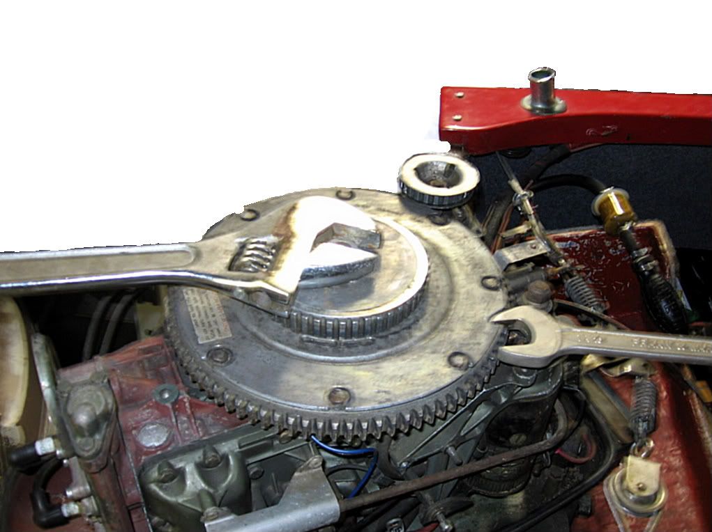

Always good to have a picture...
18 inch adjustable wrench on the flywheel nut with 1 1/8th inch cresent jaw in the flywheel notch and against the starter shaft.
