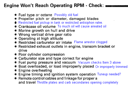

Ok, got it back from the shop. All the codes show normal stuff, but the fuel pump problem was caused by a relay that was sticking. That's fixed. Now the power problem is still there. The hole shot is crappy and to hold it on plane is a chore, once I get below a certain rpm it starts a downward spiral to being nose up. Then I have to start all over like I am in the hole even though we are still doing 10 mph (i. e. trim tabs full down, outdrive trim full down even though it is never far from full down anyway). What could be causing this problem? Could there be something in the outdrive? When I rotate the prop by hand I hear that winding sound common with what a car sounds like in reverse. Is that normal? The mech thinks it might be the computer itself, but I feel like the engine is running smooth. Ideas?
Reel Poor
Jan 29, 2005
5,522
Re: Fuel Pump problem?
Here is an outline, courtsey of DonS
