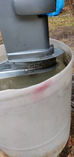

sending photo, hope this is normal

Actually, Capt, I consider that to be pretty darn clean for a 35hp running 15 mins in such a small barrel. You should see what a 1960's motor would do in there, before EPA started cracking down in late '60s. BTW, I run a 1984 35hp on my own personal boat. I consider it the best motor I've ever owned.
Allow me to explain a bit more. Every drop of oil you put in the fuel tank passes through the engine. First it goes through the crankcase, where it lubricates all the bearings and piston skirts. Then it enters the cylinders where some of it burns (and makes smoke, which people also fuss about). Then, what's left after that goes out the exhaust, where it picks up particles of carbon, creating the black stuff in your picture. On the way out the exhaust, it mixes with the cooling water, creating the other emulsion you are looking at. All this is made worse because you are running at slow speed in neutral, in a barrel, and the motor never really gets warm enough to burn much of it off.
As I said, get it out of that barrel and onto a boat, on the lake, and you should be happy with it.

Water level in that test bucket needs to be 10 " higher.------Pump impeller must submerged to work properly.
