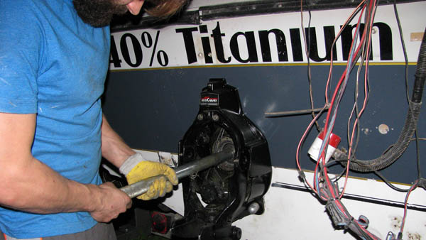

Thanks again to the masters. I didn't think it would be a good idea to glass over gel without sanding or grinding, so I've coated only the engine compartment for now. And that had a minimum of four layers of 1708 all the way around. I'm really racing against the clock here since it is getting very cold very fast and I'm doing this all outside. It was so much better grinding during the summer when it was 100?F every day. But I'm done coating anything for the season and just finished dropping the engine back in tonight. I did use 3M 5200 for the front engine-mount bolt-holes, but that stuff says it can be applied down to 40?F, which is good since it's going down to the mid-40s here each night this week.
